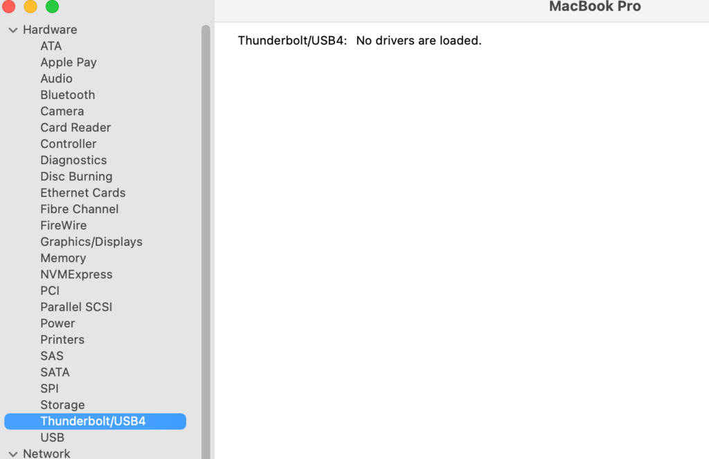

muttonhead411 Posted July 25, 2021 Author Share Posted July 25, 2021 Thanks Jake, Herve for the help. I went ahead and updated to Big Sur... and guess it wasn't a wise move. Ethernet is back to not working once again. Im not sure where to start. Jake: I removed the TYPE-C kext you provided previously, and added TPDX. Attaching latest IORegistry extract. Hope you can point me in the right direction. Thanks. Hackintel.zip Link to comment Share on other sites More sharing options...
muttonhead411 Posted July 25, 2021 Author Share Posted July 25, 2021 Update: I am also now realising that jack fix does not work on Big Sur... Maybe codecCommander does not work on BigSur? Update 2: I am now beginning to suspect my ethernet issues are due to broken XHCI in Big Sur. When i boot with the dock plugged in, ethernet port is reported in system profiler. When I unplug and replug, the port no longer appears... Is there a known fix for this issue? i have already disabled xhciport limit quirk and mapped my usb ports in catalina Link to comment Share on other sites More sharing options...
Moderators Jake Lo Posted July 25, 2021 Moderators Share Posted July 25, 2021 why did you remove SSDT-TYPEC? This is for the USB-C / TB port..might not be hot pluggable. The SSDT-TPDX is for the I2C touchpad. Sound like the USB-C is not hot pluggable. It only works on boot up. Link to comment Share on other sites More sharing options...
muttonhead411 Posted July 26, 2021 Author Share Posted July 26, 2021 Thanks Jake. Apologies, I misunderstood the purpose for TYPE-C and TPDX. I have restored both files, and have confirmed the following findings: 1) your observation is spot on again! hotplug on USB C is broken. When I retried the hub with a Type C to Type A usb cable, ethernet detection works as expected like in Catalina. Is there any way to fix this in Big Sur? When using USB A port after hot plug: When using USB C port after hot plug: 2) TPDX.aml seems to be breaking touchpad functionality (once I click on a window, it can't let go). During boot, system also generates alot of repeated text on screen. Once removed, the text does not show up in verbose anymore. Also, when checked, it was still running in polling mode, instead of interrupt. Not sure if this helps, but this is what I have from an old tool: Thanks again for your help. Really appreciate it very much Link to comment Share on other sites More sharing options...
