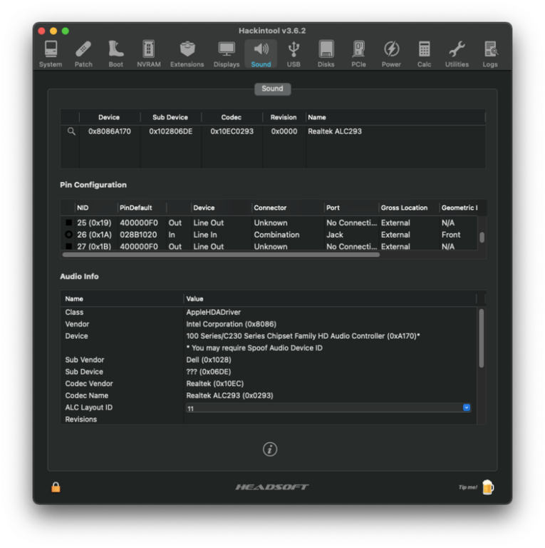

PMD Posted July 15, 2021 Share Posted July 15, 2021 It works like a charm when I choose Internal Microphone but I want to make use of my headphone's microphone for better noise cancellation. I'm using id 11 with AppleALC. Is this normal? Link to comment Share on other sites More sharing options...

PMD Posted November 2, 2021 Author Share Posted November 2, 2021 Hi, I think something is wrong. I see 2 ports showing green dot in Hackintool and they are functioning properly. Meanwhile, the remaining port that is not working is Line In, which is not showing green dot. Mine is ALC293, I am using AppleALC with layout_id=11. Below is my ioreg file. In addition, I tried CodecCommander but it's still the same MBP.ioreg Link to comment Share on other sites More sharing options...
