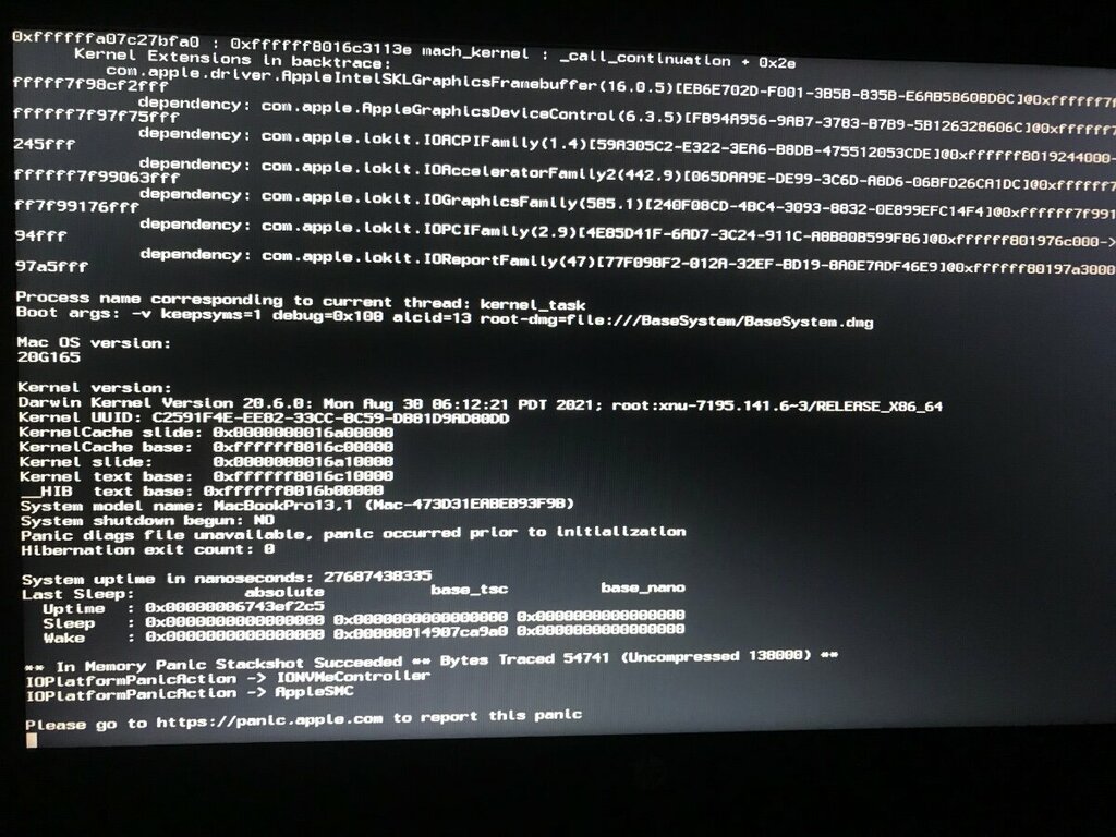

adam sallimou Posted October 20, 2021 Author Share Posted October 20, 2021 It brings me a panic, here is the photo: Link to comment Share on other sites More sharing options...
Moderators Jake Lo Posted October 20, 2021 Moderators Share Posted October 20, 2021 what type / model hard disk is on this system? Certain NVMe drives are not compatible...like Samsung PM981, PM981a. Link to comment Share on other sites More sharing options...
