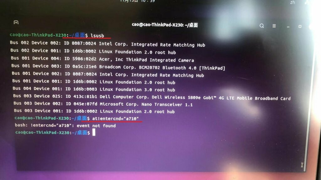

LTE-Card Posted November 15, 2021 Author Share Posted November 15, 2021 I am use Ubuntu OS The em7305 wwan card good work in Linux and Windows 10 I can see em7305 hardware in terminal but i don't know how to use AT command Could you help me .thanks Link to comment Share on other sites More sharing options...
Administrators Bronxteck Posted November 15, 2021 Administrators Share Posted November 15, 2021 why enter "a710" dont you have to declare the gobi then what you want to do to it? Link to comment Share on other sites More sharing options...
Administrators Hervé Posted November 15, 2021 Administrators Share Posted November 15, 2021 You can't enter an AT command at the Linux prompt! You need to be connected through a terminal app to the serial port attached to the modem... Link to comment Share on other sites More sharing options...

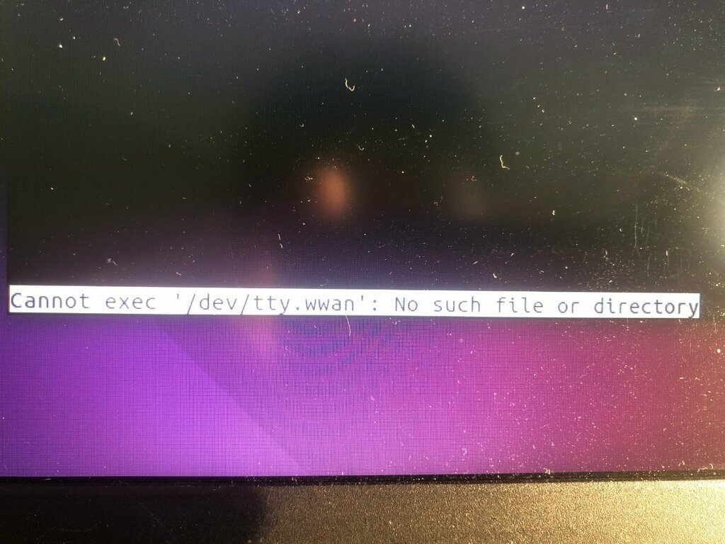

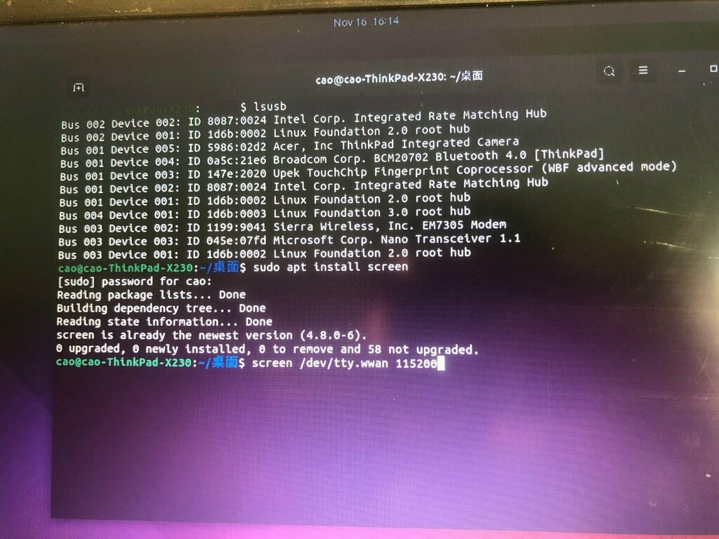

LTE-Card Posted November 16, 2021 Author Share Posted November 16, 2021 Yes, I just typed this command and prompted an error code Cannot exec'/dev/tty.wwan':No such ffile or directory Is there another step that needs to be set? Thanks Link to comment Share on other sites More sharing options...
Administrators Hervé Posted November 16, 2021 Administrators Share Posted November 16, 2021 You're not targetting the correct device so you need to identify that 1st. Check the /dev directory to begin with... Link to comment Share on other sites More sharing options...

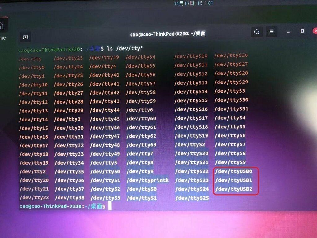

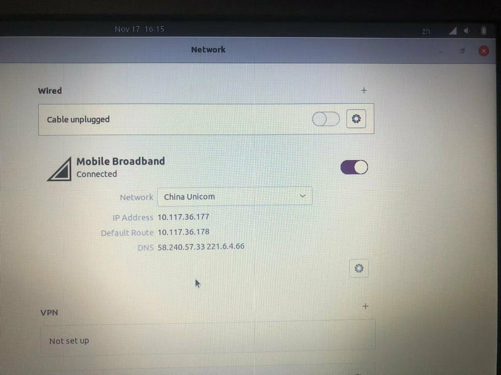

LTE-Card Posted November 17, 2021 Author Share Posted November 17, 2021 When I plug in the em7305 network card and sim card in my X230 machine The computer can go online normally After the lsusb command is entered, three usb devices are displayed (ttyUSB0 ttyUSB1 and ttyUSB2) What command do I need to enter, then I can get the link em7305 and I can enter AT commands Thanks again Link to comment Share on other sites More sharing options...
Administrators Hervé Posted November 17, 2021 Administrators Share Posted November 17, 2021 Then, target those tty devices individually with your screen command. See if any gets you on the modem. Link to comment Share on other sites More sharing options...
