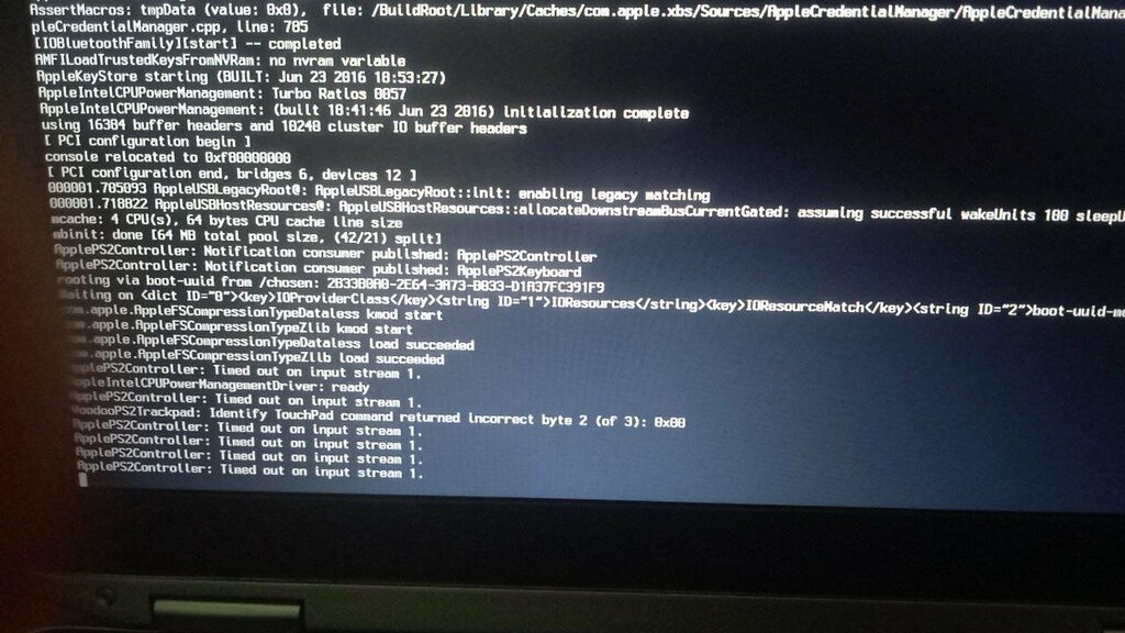

luca_big_sus Posted February 22, 2022 Share Posted February 22, 2022 hi i made an open core efi to install Mac OS on my dell latitude E6320, the problem is everything works fine but the installer won't load, the last thing that does is: ApplePs2controller: timed out on input stream1 and it goes on spam for like 5 times and then the non accessible logo and glitched text, like a sort of panic. I can send the efi. Link to comment Share on other sites More sharing options...
Moderators Jake Lo Posted February 22, 2022 Moderators Share Posted February 22, 2022 which version of MacOS are you installing? SandyBridge only go as far as High Sierra if you want graphics support Post your EFI folder Link to comment Share on other sites More sharing options...
Administrators Hervé Posted February 22, 2022 Administrators Share Posted February 22, 2022 Also post your system's specs, ideally in signature. Only the Intel iGPU is supported in macOS, not the nVidia dGPU if you have that model. As Jake said, High Sierra is the last version to officially support HD3000 graphics. Patches are available for Mojave and Catalina that allow to run HD3000 graphics in OpenGL mode only (no Metal support) but it's not really recommended, HD3000 graphics being buggy enough when fully officially supported. Forget about Big Sur and Monterey though. Don't hesitate to consult our E6220 guide in the Guides section. Link to comment Share on other sites More sharing options...
