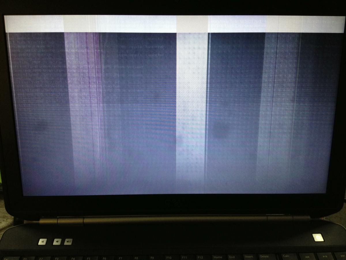

pratchaya Posted April 10, 2013 Share Posted April 10, 2013 I got error stuck on the white+black error screen when try to installation OSX. I use "myhack" method. Case#1 1. create OSX installation bootable via myhack ( ML 10.8.3 ) 2. try to install and got this error Case#2 1. create OSX installation bootable via myhack ( ML 10.8.3 ) 2. install extra via myhack use E6520 bootpack 3. try to install and got this error Case#3 1. create OSX installation bootable via myhack ( ML 10.8.3 ) 2. install extra via myhack use E6520 bootpack 3. + install extra via myhack replace DSDT of E5520 from https://osxlatitude.com/index.php?/topic/1615-dell-latitude-e5520/ , Dell Latitude E5520 DSDT.zip 4. try to install and got this error All case i use many option boot 1. -v 2. -v -f -x 3. PCIrootUID=0 npci=x3000 All got the same error like picture that i hv attached. Please help me sir. Thank you very much in adv. Note Link to comment Share on other sites More sharing options...
Administrators Hervé Posted April 10, 2013 Administrators Share Posted April 10, 2013 What's the graphics controller on that laptop? Did you try the generic bootpack (Create Extra -> Generic) provided by myHack at all? Please note that the syntax of the options you've used appear erroneous (PCIrootUID=0 npci=x3000). Note that, by default, the PCI root id is 0. Try the following options instead, respecting the syntax: PciRoot=1 npci=0x2000 PciRoot=1 npci=0x3000 You may also want to try: GraphicsEnabler= You should use a DSDT that matches your hardware, i.e. not use the table from another model unless is closely matches the configuration of your own model or not use the table of a similar model but with different hardware (like different graphics controller). That will likely cause unrecoverable issues. On looking at the specs of the E6520, it appears there is no way you can use its DSDT on your E5520; the 2 systems are not based on the same chipset. The post you refered to looks suitable and the DSDT table provided should work as long as you too have the Intel HD3000 graphics controller. On checking the Dell documentation, it appears the E5520 was also made with the earlier Intel HD graphics controller. Then there are 2 different screen sizes: HD and FHD. That could require DSDT patching too... So, provide us your full system specifications and we'll take it from there. Link to comment Share on other sites More sharing options...

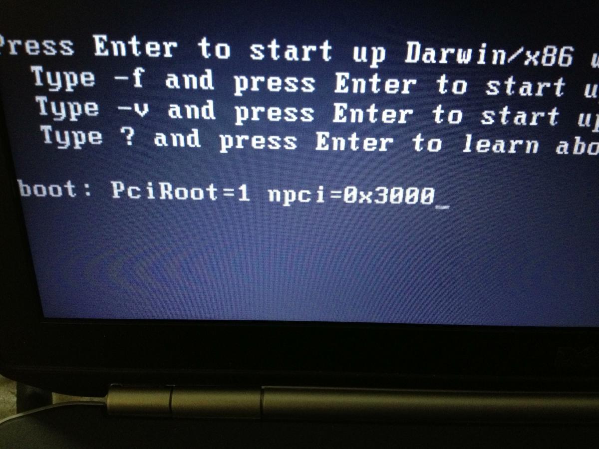

pratchaya Posted April 10, 2013 Author Share Posted April 10, 2013 Hi , Herv'e I try again with this solution. 1. create OSX Installation bootable ( ML 10.8.3 ) via myHack. 2. install extra -- > generic 3. try to install and got stuck this error PS. I try with several options. such as 1. -v 2. -v -f -x 3. PciRoot=1 npci=0x3000 So, It's got the same error like picture i hv attached. sir Please help me . Note Link to comment Share on other sites More sharing options...

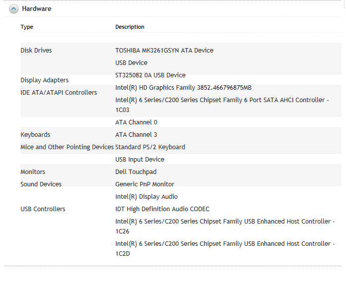

pratchaya Posted April 10, 2013 Author Share Posted April 10, 2013 This is my sepc. Link to comment Share on other sites More sharing options...
Administrators Hervé Posted April 10, 2013 Administrators Share Posted April 10, 2013 Ok, well it looks like it's not the Intel HD3000 graphics but the Intel HD graphics controller. As such, the DSDT previously posted for the E5520 does not probably suit your machine... I would suggest you request a DSDT patching job using the documented process in the Research -> DSDT section. It's all detailed here: https://osxlatitude.com/index.php?/topic/1945-dsdtssdt-patching/ Link to comment Share on other sites More sharing options...

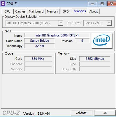

pratchaya Posted April 10, 2013 Author Share Posted April 10, 2013 Just sent AIDA64 files to dsdtssdt@osxlatitude.com But i try cpu-z. it show my Graphic card = Intel HD3000 . AIDA64.rarFetching info... Link to comment Share on other sites More sharing options...
Administrators Hervé Posted April 10, 2013 Administrators Share Posted April 10, 2013 Ok, well, the posted DSDT should be Ok then. Link to comment Share on other sites More sharing options...
Moderators Jake Lo Posted April 14, 2013 Moderators Share Posted April 14, 2013 On 4/10/2013 at 9:49 AM, pratchaya said: Hi , Herv'e I try again with this solution. 1. create OSX Installation bootable ( ML 10.8.3 ) via myHack. 2. install extra -- > generic 3. try to install and got stuck this error PS. I try with several options. such as 1. -v 2. -v -f -x 3. PciRoot=1 npci=0x3000 So, It's got the same error like picture i hv attached. sir Please help me . Note Looks like you might be having display driver loading issue. Try generating a smbios.plist with Chameleon into the generic extra folder and use GraphicsEnabler=Yes during boot or enable it in boot.plist. Use smbios.plist that emulate a mac model that utilizes the HD3000 (MacBook Pro 8.1) for it to be initialized correctly. Link to comment Share on other sites More sharing options...
