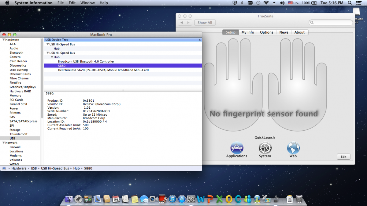

Finger scanner may not actually need a kext, well if it's listed under USB section, it may not. You will however need a soft to use configure your system to use it as a replacement of passwords...
Finger print reader is a broadcom 5880 device. It does show up in the USB device list
