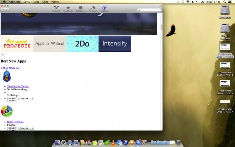

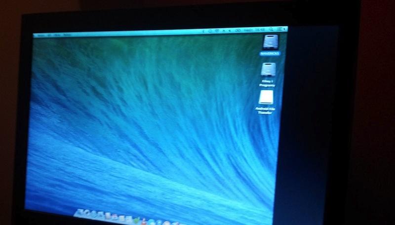

vsbosx Posted November 28, 2013 Share Posted November 28, 2013 1.Bluethoot - It's working but I can't turn it off , only in BIOS but I need it sometimes. I have Bios version A34 2.Touchpad - Is there any chance to get multi-fingers future to work ? I't realy would make my life easier. 3.Sleep/wake- If screen will lock i can get pass it but when it goes to sleep I can't wake it. I don't use sleep enabler, I have only add to terminal the line in link above. 4.Vga port - When I plug monitor in Vga port, monitor led lights up and turn off. Mac don't recognizes any device pluged in VGA. 5. Power button - I've used kext from one user in link above "AppleACPIPlatform.kext" and only one time Power button work when I restart my notebook. 1time per restart. And I think that Nvidia NVS 160m kext is still need to work on…… Everything just frezzz I can just slowly move the desktop a bit to the left and right. And also Appstore and I books works time to time And sorry for my bad english. Same for me and BT Pref Pane 'Turn Bluetooth Off' button is greyed. I tried a CLI method and it didn’t really work as expected and I didn’t look deeper since I don’t mind it being on all the time as the power drain w/ no devices attached is very low I’d imagine. You can disable both BT and WiFi via the right-side hard switch and it re-enables fine, but losing WiFi is likely a deal-breaker. I read on a few forums the E6400 touchpad is simply not capable of true multi-touch and any kext's I tried didn't work, although I wouldn’t mind someone proving us all wrong. The touchpad is a bit small even if multi-touch worked but if we can at least get the side and bottom scrollbars working, that may be barely suitable, but again my attempts at multi-touch and scrollbars didn't work. Instead I plan to pair a Logitech Touchpad or Apple Magic Trackpad for docked use at least. Same issue with sleep and it’s the only feature I’d ​really like to get working. With 'hibernatemode 0' and rm'd sleepimage, I can get it to sleep and wake at least once and in some cases, a string of times, but eventually it won’t wake again so I simply don’t rely on it. Read below for more info. I did the force 'Detect Displays' trick as you and others mentioned and it worked for me also. Maybe I can help here. At first I was only getting it to work once per boot but then followed howoarang’s advice (thanks!) [https://osxlatitude.com/index.php?/topic/2674-dell-e64006500m4400-mavericks-109-gm/?p=23955] and it worked for me after I run it via myHack using the steps below. Let me know if it helps you. Installed/overwrote AppleACPIPlatform.kext from the above link by copying into Extra Folder and re-running myHack 'Install Extra' after initial install. If installing OS X from scratch, I would just overwrite/include it initially into the USB Extra folder which would be more seamless. I have the NVIDIA Quadro NVS160M 256MB video card I believe and it’s been working great for me w/ the kext’s DaFOB included in his pkg. I launched App Store and see no issues or with anything else thus far. My notes/comments: BT LED appears to work, but WiFi LED doesn’t. Not a big deal but curious. I use mine w/ a Dell Docking station and:One DVI output works but the second one doesn’t. Instead for dual-monitor I’m using a DisplayLink USB to DVI display adapter with their latest Mavericks driver and it works quite well with the only downside being much longer increased shutdown time. With an SSD in the E6400 it would shutdown in a few seconds and now it has the spinning lines for 15 or more seconds. Not a big deal in comparison to the dual-monitor capability. Dell laptop display stays on all the time, even with the lid closed and becomes my 3rd monitor. I tried to find a way to disable it and haven’t figured that one out yet. If anyone has hints, please share. Since ventilation pulls from the bottom, I just turn the LCD brightness down to minimum and don’t worry much about it. I have to say, versus even a Late 2006 MBP running SL, this Dell E6400 running Mavericks is very sweet since the graphics are smoother and overall performance is very good considering the age, specs, and fact that OS X wasn’t intended to run on it. To get even better performance, toss a SSD in there and since OS X won't enable TRIM on non-built in Apple SSD, if your SSD supports TRIM, but sure to run the myHack or equivalent TRIM enabler.. I'm booting from an ancient 30GB SSD and it’s extremely snappy in terms of start-up and app launch. I ordered a media tray HDD adapter and if it works, will likely upgrade the internal drive and use the 30GB for dual-boot or otherwise from the media tray. Thanks to DaFOB and especially the myHack genius(es) for making this fairly painless! We should all donate [http://myhack.sojugarden.com/donate/] since it's uber cool what they do for the community for free and a little cash to cover at least their webhosting is undoubtably appreciated considering how much potential enjoyment we'll get out of this on the cheap. BTW - I'm not affiliated with myHack and simply truly appreciate their community work. Lastly, your English is much, much better than most of our Polish or other EU languages. Same problem with sleep on E6500. Works once fine. If sleep image does not exist, sleep works. But it seems to get created or seems to exist even when suspend to RAM is ON. Not an expert, but is there a way to capture the sleep event and run a shell script (sudo rm /var/vm/sleepimage) to delete the file every time sleep is called (just before the sleep happens)? Or maybe delete it just before wake starts to process it? Or prohibit write of this file using permissions? Please ignore if this sounds stupid…A newbie here. But really need sleep to work to use the laptop... I also thought the re-appearance of the sleepimage file may be a problem, but with 'hibernatemode 0' and sudo rm'ing it, I’m not seeing it reappear with any frequency. Still, I can get sleep to work for 1 or more times but will bomb out again eventually which is a bummer. I think initially I could only get it to sleep once but some other tweaking with different kext files got it to multiple sleeps but still no guaranteed consistency. I’ve tried looking thru the Console logs after good and bad sleep tests using the power button Sleep, |Sleep, and lid close. After a cursory look, didn’t notice anything in particular that always shows during bad versus good waking, but also haven’t had time to really dig in deep and diff the logs. For now I’m just setting Energy Saver to multi-hour sleep and w/ SSD, startup and shutdown are fast enough that I don’t really mind. Link to comment Share on other sites More sharing options...
