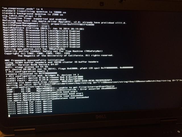

recently I tried the same. But now I'm able to install a Niresh Maverick distribution with a haswell patched kernel.
I took really a long time to find out that boot up procedures will not cope with ACPI configurations from DELL.
I copied the haswell pre-patched kernel from here to the root filesystem to my Niresh Maverick USB 8 GB media. The Installation to msata device takes round about 25 minutes.
Intel Ultimate-N 6300 AGN will not work. Thinking about a replacement broadcom mini pci express card....will need the best ootb part.
After the Installation, I will report more about the configuration. First I have to fix boot issues.

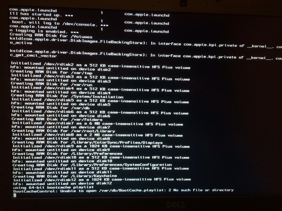

Hi,
installing Mavericks Niresh was so slow that interupted the installation. So I switched to usb 2 extern HDD:
Problems so far:
- Internal HD 4600 works only with HDMI monitor plugged in. Resolution depends on  the EEID of the external monitor. HDMI Port does' show up any GFX
- No audio with the latest voodoohda
- Sleep and Speedstep not working....
I use Clover to boot. Tests with chameleon will follow.

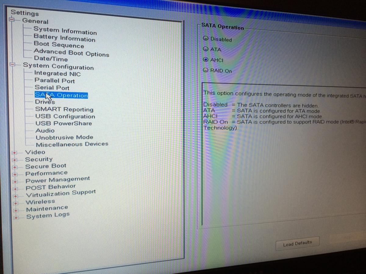

ive been trying the past few days,
i installed using unifail created USB with a patched kernel..
install is ok,
but i still cant get the touch pad to work, will buy a USB wifi tomorrorw.. and only my left side usb port works the ones on the right dont, ethernet works with no changes, cd drive works,
do you have the same problem.
i managed to get the battery meter runing. it works about 60% of the time. ill keep you updated, please do the same. my priority is the touchpad,

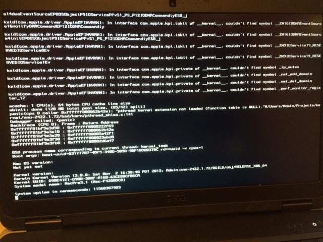

Hi,
I was trying to get rid of NullCPUPowerManagent.kext to get speedstep working.
My DSDT.aml compiled without errors with the help from toledo ML HDMI repository:
http://www.insanelymac.com/forum/topic/292999-mavericks-applehda-hdmi-audio/
But I get kernel panic when I boot with my DSDT.aml files copied to /EFI/CLOVER/ACPI/patcged/.
Can we check the Bios versions? I recently updated mine to A07.
My Audio Controller reported from BIOS A07 is a Realtek ALC3226. I Will check the kext from Jake Lo. Thanks.
Kind regards
 Macintoshy
System DSDT_patch_sourceForge.zip
