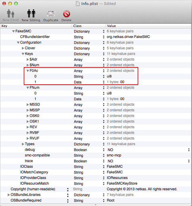

Administrators Hervé Posted March 23, 2014 Administrators Share Posted March 23, 2014 I never said I did not have that error. I do actually get it with the very recent FakeSMC version I'm using. Can't remember if that existed with earlier v5.2.678 or otherwise... Bottom line is: does this affect the way your D630 runs at all? It does not as far as I'm concerned. Link to comment Share on other sites More sharing options...

Administrators Hervé Posted March 23, 2014 Administrators Share Posted March 23, 2014 That key is used for Fan speed monitoring, so even if FakeSMC is complaining it, it has no impact. Feel free to add it to your FakeSMC Info plist file and your error will disappear. Quick search on the Net: FNum - tells you how many fans are in the systemTo read data from each fan:F0Ac - Fan actual speedF0Mn - Fan minimum speedF0Mx - Fan maximum speedF0Sf - Fan safe speedF0Tg - Fan target speed So, you could add the following for instance: Link to comment Share on other sites More sharing options...
