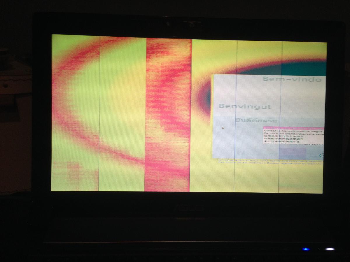

Hi Everyone..
So, I also have the N53S.
Then at the bottom it said: MB version: N53SV.
I installed the vanilla version, and then used a folder thats on the internet with all the different drivers.
I have to say my system is being working flawless.
Now, here is my problem. as you all know this machine comes with the resolution of  1366x768.
SO I decided to do the LCD + video cable upgrade and Voila !! I now have 1080 resolution.
problem is that now i cant see my desktop. all i get is video garbage.
I tried the -x flag to get it to boot up and them i could try another Kext but i cant see nothing.
i even tried the -x -v flags with my USB hack install stick but as you can see on the pic the flags do not help.
any ideas ?

You have to enable DualLink in your DSDT.aml. If possible, please attach your Extra folder.

Patched your DSDT with dualLink. Rename your DSDT to dsdt.aml.old and rename this as DSDT.aml in /Extra. Maybe change you Graphics Mode to your new resolution as well.
DSDT-duallink.aml.zip
  • Like 1
Well Thank you so very much JAKE LO.
That totally fixed my machine !!
now i have OSX Mountain Lion running at 1080.
it looks wonderful !
