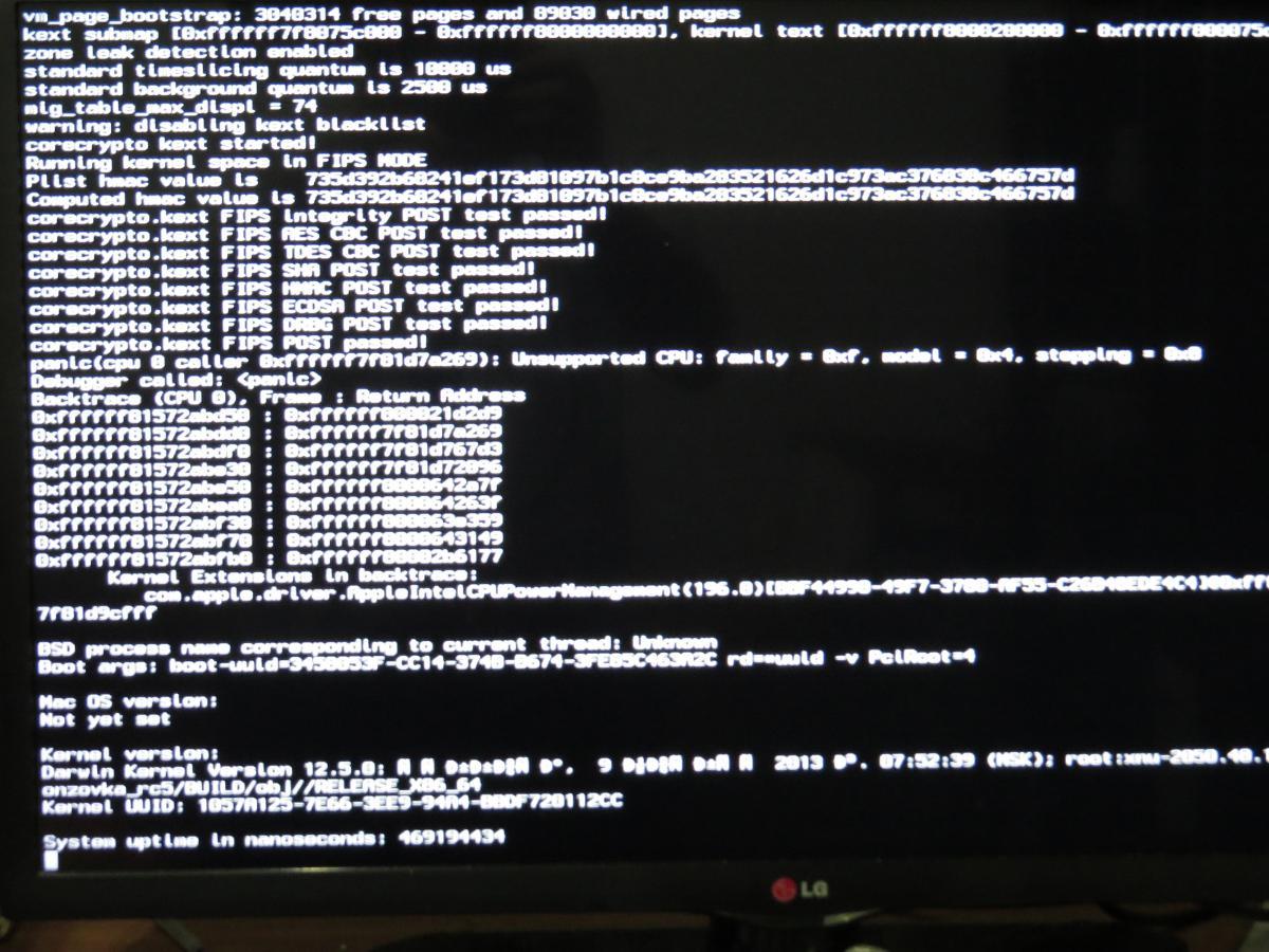

vanguart Posted May 30, 2014 Author Share Posted May 30, 2014 last update. Yes i am in safe mode all the time. ML 10.8 i did clean install. using generic kext from myhack. i can boot using -v -x PciRoot=4 or EFI string inject. if i boot normally without -x , i got black screen after cameleon intro . if i boot with -x but without PciRoot=4 i got black screen in the end of boot. Link to comment Share on other sites More sharing options...
Administrators Hervé Posted May 30, 2014 Administrators Share Posted May 30, 2014 You will never get graphics working unless you enter the PCI root value that matches the default DSDT in BIOS or you use a DSDT to overwrite it to 0. Can you please zip your /Extra and post it here? Link to comment Share on other sites More sharing options...

vanguart Posted May 30, 2014 Author Share Posted May 30, 2014 Print screen . trying to boot (no safe mode). Normal Mode. if i use -x , i can boot, but only in safe mode. Link to comment Share on other sites More sharing options...
