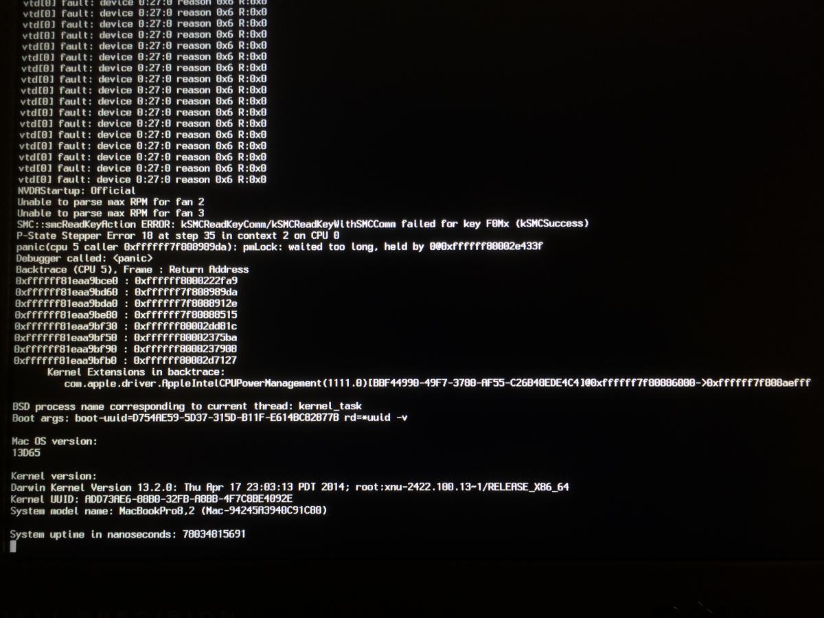

bigapple Posted July 7, 2014 Author Share Posted July 7, 2014 Ok so here's where I'm at so far: 1. Recreated my usb boot disk with myHack 2. Installed the bootpack that was created for the EliteBook 8560w 3. Replaced the default installed ssdt.aml file from the EliteBook pack with the ssdt_i7-2720QM.aml (should I be replacing it in original bootpack before installing?) 4. Booted Dell m4600 with myHack thumb drive and get following error. Sorry for the bad quality, I had to pull from video: 5. Removed ssdt.aml file and rebooted from the thumb drive, then got this error: Not exactly sure what to do. Just wondering, should I have a completely erased hard drive before starting this or is it ok that it currently has my old Windows 7 installed w/partition, etc.? I thought it could be formatted/partitioned during install but correct me if I'm wrong. Thanks again! Link to comment Share on other sites More sharing options...

bigapple Posted July 7, 2014 Author Share Posted July 7, 2014 Ok so I added the nullcpu kext to the extras folder and did a my fix (quick). 1. Rebooted to thumbdrive (with ssdt.aml for 2720QM) and got the same error above in the First Error.jpg image. 2. Rebooted to thumbdrive (removed ssdt.aml for 2720QM) and got the error below: A few things worth noting: - the screen goes completely black on most of these errors after it hangs. - Whenever I've run myHack it never prompts me to add the extras folder. I always have to run myHack again and add extras then. I copied the original dmg file to the applications folder, installed it, and then run the myHack app from there. Link to comment Share on other sites More sharing options...
Administrators Bronxteck Posted July 7, 2014 Administrators Share Posted July 7, 2014 AppleIntelCPUPowerManegment then needs to be removed from your Extra folder as it does not seem compatible with your version of osx. and in the picture above it shows that you have Vt-d enabled in bios. unless you need it in windows for some reason turn it off as it causes issues. or add boot flag dart=0 Link to comment Share on other sites More sharing options...
