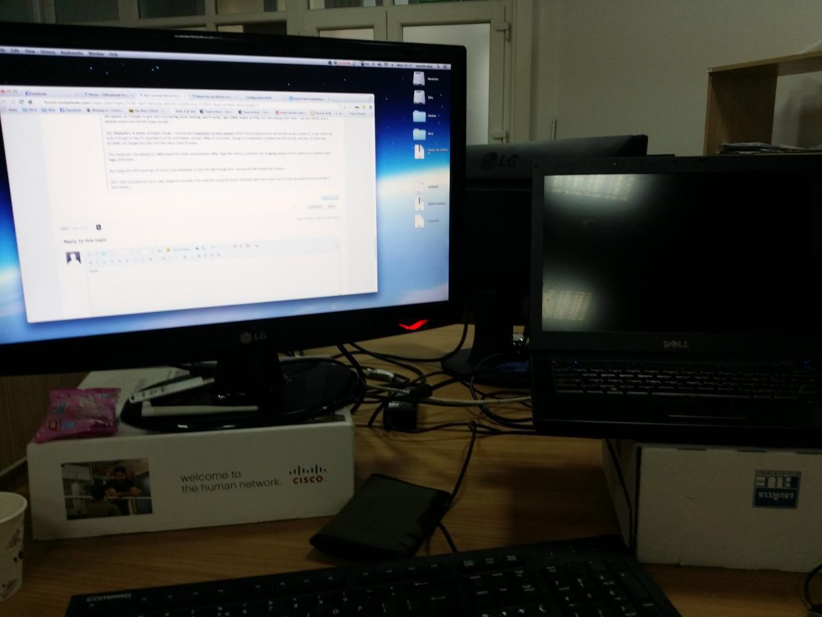

This is the VGA Output, as you can see, a 24 inch monitor connected through VGA, though built-in display is non functional...
As soon as i get home, i will take a picture of the DisplayPort as well...
