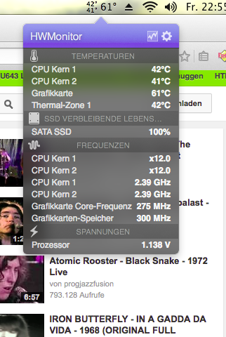

Axel-Erfurt Posted October 10, 2014 Share Posted October 10, 2014 I think T7250 and T7500 produced a higher temperature than T8300 I replaced the T7500 in my old D630 with T8300 and the temperature is lower than before. (playing Youtube Video in Firefox - HWMonitor CPU:36ºC GPU:60ºC) Link to comment Share on other sites More sharing options...

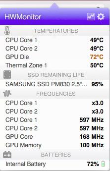

Administrators Hervé Posted October 10, 2014 Administrators Share Posted October 10, 2014 Woaw, keep that special D630n preciously, because such low T° at max speed is quite simply amazing! Yes, I meant CPUSensors of course, my mistake... This is mine, idling... It does not matter which FakeSMC I'm using (running 6.9.1315 at the moment) and I even have a copper shim on the GPU! Link to comment Share on other sites More sharing options...
