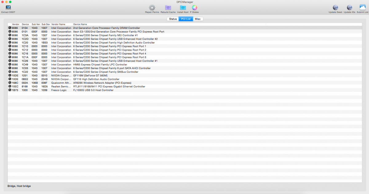

wollywolf Posted May 1, 2015 Author Share Posted May 1, 2015 Hi, Yup, I'm sure...I don't know why on the list, It does not appear, Below you can see the specifications. http://www.asus.com/ROG_ROG/G74SX/specifications/. Thank You. Link to comment Share on other sites More sharing options...
Moderators Jake Lo Posted May 1, 2015 Moderators Share Posted May 1, 2015 Was it working with 10.10.1? If so, what kext were you using? Link to comment Share on other sites More sharing options...
wollywolf Posted May 1, 2015 Author Share Posted May 1, 2015 Hi, No, It never woked with iOS, Even with 10.10.1. but It worked with Windows ... Thank. Link to comment Share on other sites More sharing options...
