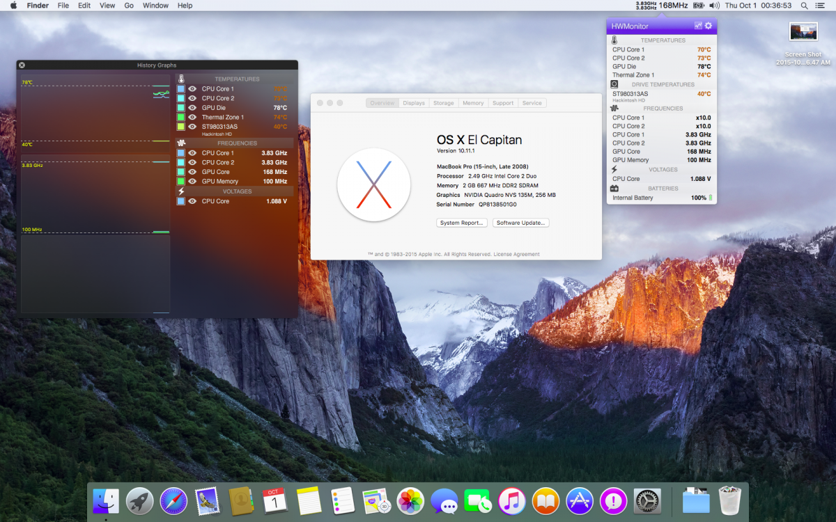

gti-rcdn Posted October 2, 2015 Share Posted October 2, 2015 I have this D830 with a T9300 2.5GHz c2d and the 140M.. I had a good mavs install and just before the release of El Capitan I got antsy and took the plunge on my laptop to the gm release candidate. Install was tricky, I also figured out clover with the help of other threads and the bootpack combined through trial and error. Now I am running all the kexts from the mavs bootpack except for the few mentioned in the smc and performance tuning thread. I am using a dsdt from the same bootpack with edits to enable usb. Needless to say this is how it was running the other day... 3.83GHz!! thats gotta be wrong? and after a while the gpu clock stays at 400MHz. I can't sleep the computer. It works but I don't have working wifi in it yet, so it will disconnect the lan after sleep. Apple fed me an update to public beta 1 after the release candidate and I still have not seen an update in the store to the actual release out yesterday Anybody have insight on these issues? Also, today seems to be good. I booted it up and the fan stayed off for 5 minutes almost.. then slowly tuned up and up. The fan is almost never off on boot. Been almost an hour and gpu clock is switching states, and the CPU wasn't at 3.83 GHz Link to comment Share on other sites More sharing options...

Administrators Hervé Posted January 28, 2016 Administrators Share Posted January 28, 2016 What wifi card do you have? Incorrect reported CPU speed could be due to the bus speed configured in your Clover config file. With a Penryn C2D, it should be set to 200000khz (200MHz, i.e. the base speed of the quad-pump FSB). GPU sticking at 400MHz is clearly a lack of tuned AGPM. You can lookup the dedicated thread on the matter in the R&D ->Other research section. I've also posted details of the manner in which you can incorporate this particular tuning into FakeSMC, thereby removing the need to patch AGPM kext after each update or installation. I'll have to check LAN status after wake since I hardly ever use it. I certianly don't recall experiencing loss of LAN after wake, yet I have virtualization enabled in BIOS; but I'll check this out on my D630 under EC. Link to comment Share on other sites More sharing options...
