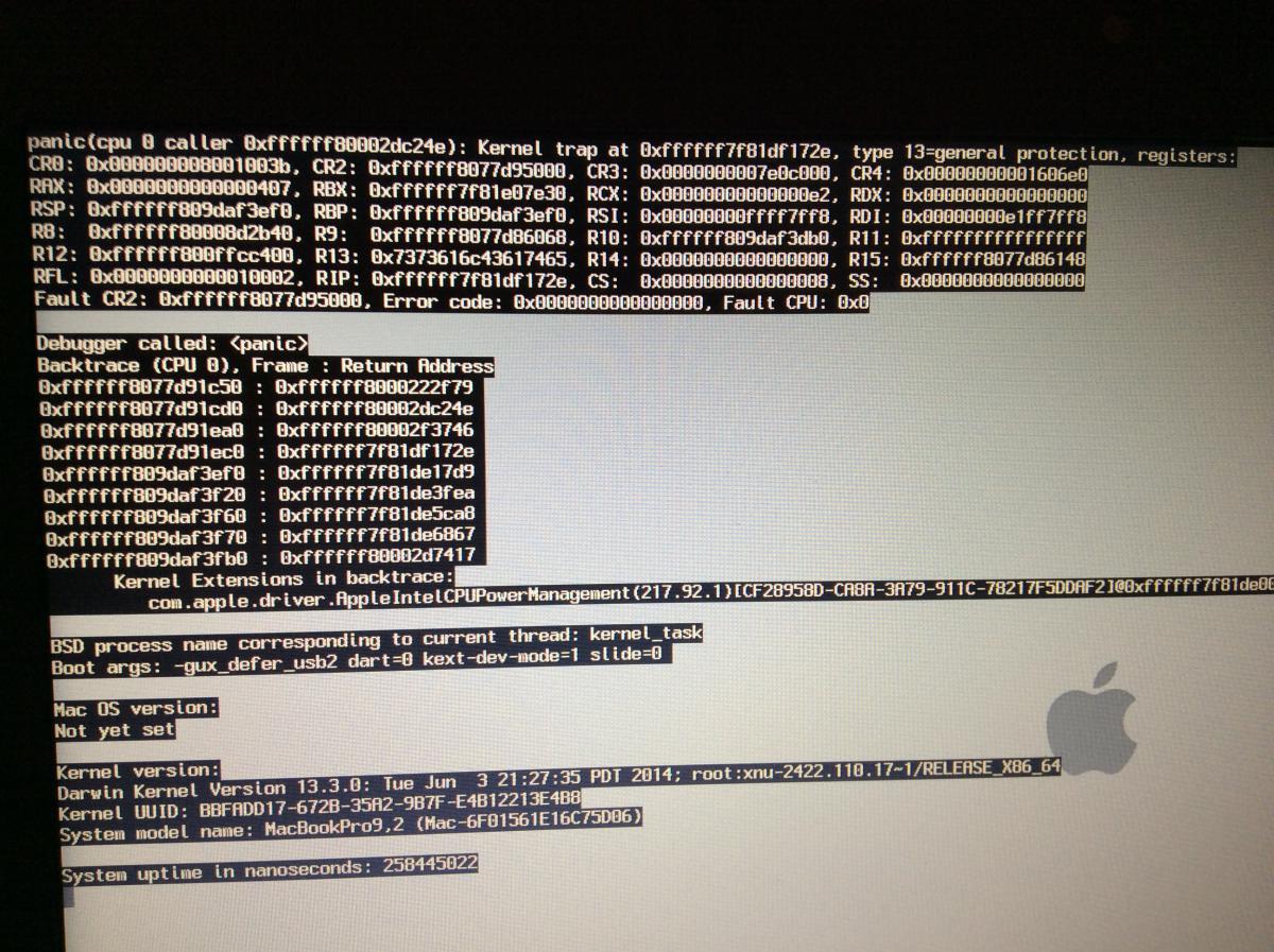

firewall Posted November 8, 2015 Share Posted November 8, 2015 Looking for some help please in getting Mavericks installed onto dell e6430. Trying to follow this guide https://osxlatitude.com/index.php?/topic/6372-dell-latitude-5x30-6x30-clover-install-guide/ Can get to clover at startup but select install mavericks then get kp with type 13 general protection registers! Can anyone please point me in the right direction of where I have gone wrong? dell e6430 1600 x 900 hd4000. Appreciate any help or pointers thank you Link to comment Share on other sites More sharing options...
Moderators Jake Lo Posted November 8, 2015 Moderators Share Posted November 8, 2015 attach a screenshot here. Link to comment Share on other sites More sharing options...

Moderators Jake Lo Posted November 8, 2015 Moderators Share Posted November 8, 2015 when the system crash, take a picture and attach it here. Use the 'More Reply Options' to attach files. 1 Link to comment Share on other sites More sharing options...
firewall Posted November 9, 2015 Author Share Posted November 9, 2015 Thanks Jake Lo again for offering to help hope this attached photo explains better than I am doing. USB was done on old laptop Have hopefully managed to copy correctly to USB and have got to below stage 4. Restart with USB plugged in a USB 2.0 port, select these options in BIOS: - Function keyboard: Function mode- Disk: AHCI- UEFI Boot: Enabled- Secure Boot: Disabled- Legacy Rom: Disabled- Add boot option: Add EFI\Boot\Bootx64.efi in USB, then move the boot entry to top. Save settings and restart. 5 Clover bootloader screen will show up (if not, add Clover in USB in BIOS again), select "Boot OS X Install from xxxxxxx" (your OS X Installer partition). This is where it all goes tits up. Link to comment Share on other sites More sharing options...
Administrators Bronxteck Posted November 9, 2015 Administrators Share Posted November 9, 2015 you need asus pm patch from clover. Link to comment Share on other sites More sharing options...

Administrators Bronxteck Posted November 9, 2015 Administrators Share Posted November 9, 2015 it was in the picture you posted "kernel extension in backtrace" it means you need a Power Management patch. in config plist under <key>KernelAndKextPatches</key><dict> you need to add <key>AsusAICPUPM</key> <true/> 1 Link to comment Share on other sites More sharing options...
Moderators Jake Lo Posted November 9, 2015 Moderators Share Posted November 9, 2015 It's for power management which is not supported natively and require a patch such as the one Bronxteck suggested. You could use NullCPUPowermangement will be fix that KP or since you're using Clover, enabling that will automatically patch the kext for you. Open the Config.plist with Clover Configurator 4.24/4.25. Under Kernel and Kext patches, enable 'Asus AICPUPM' 1 Link to comment Share on other sites More sharing options...
