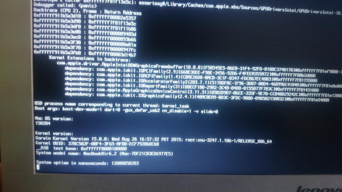

ypdeveloper Posted February 25, 2016 Author Share Posted February 25, 2016 Hey jake please help me i get this kernel panic again i reattach my efi folder and error when i try to inject hd5500 kernel panic come again due to preallocated Dvmt please solve me for once Working OSX.rar z51-70EFI.rar Link to comment Share on other sites More sharing options...
Moderators Jake Lo Posted February 25, 2016 Moderators Share Posted February 25, 2016 Looks like your graphics FB is not getting patch on the fly. You'll have to manually patch it and install to /S/L/E Link to comment Share on other sites More sharing options...
marto Posted February 26, 2016 Share Posted February 26, 2016 copy the patched BDWFB to your installed drive and repair permission. How do I do Thank you Link to comment Share on other sites More sharing options...
Moderators Jake Lo Posted February 26, 2016 Moderators Share Posted February 26, 2016 Assuming you have the patched FB in your USB installer, that's why you're able to boot and install OSX Boot to the USB installer, click on Options -> open Terminal, and enter the following: diskutil list sudo cp -R /Volumes/<name of your USB installer>/System/Library/Extensions/AppleIntelBDWGraphicsFramebuffer.kext /Volumes/<Your OS HDD>/System/Library/Extensions/ Close terminal and reboot to your HDD Link to comment Share on other sites More sharing options...
