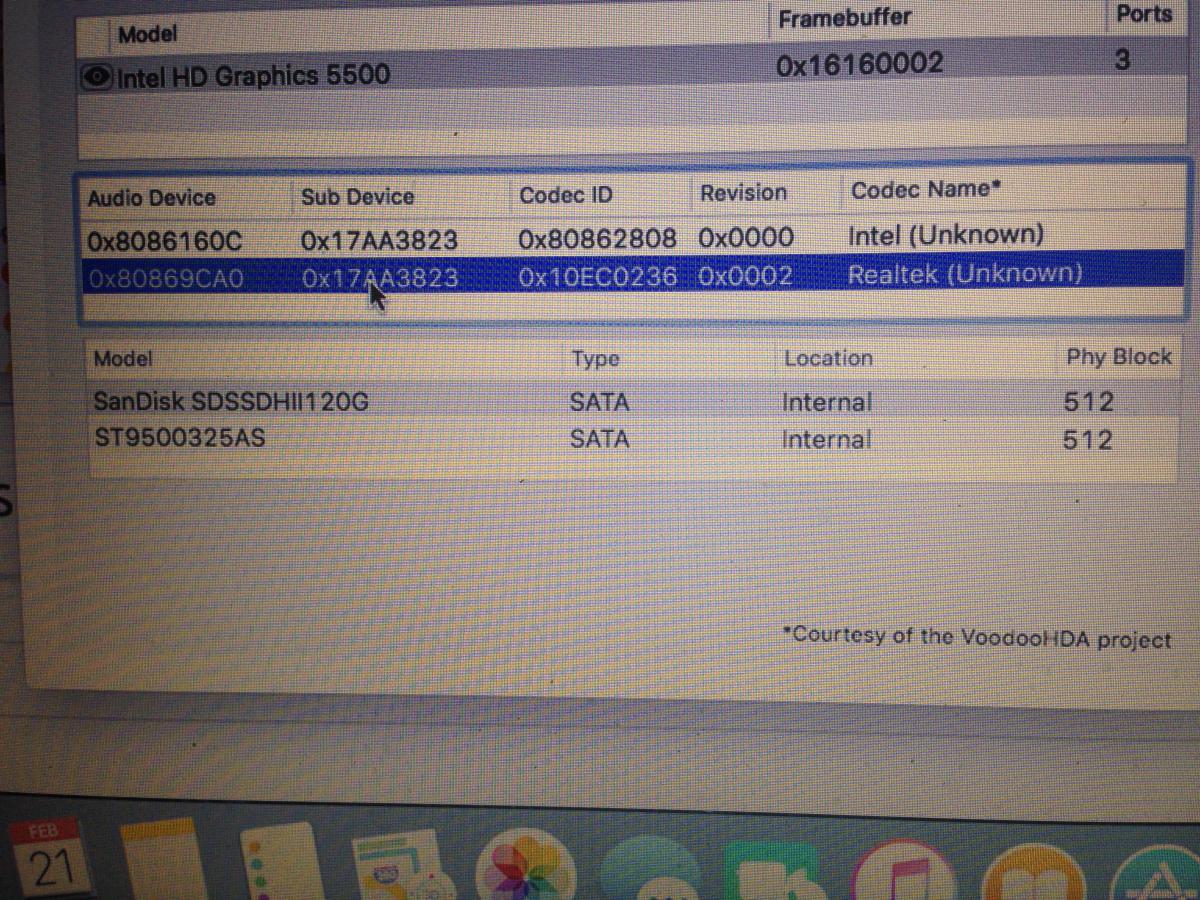

Moderators Jake Lo Posted March 15, 2016 Moderators Share Posted March 15, 2016 Did you install AppleHDA_ALC236.kext to /S/L/E or /L/E and then fix permission and rebuild cache? Link to comment Share on other sites More sharing options...
REEMA Posted March 15, 2016 Author Share Posted March 15, 2016 Hello Jake Yes i did Link to comment Share on other sites More sharing options...
Moderators Jake Lo Posted March 15, 2016 Moderators Share Posted March 15, 2016 Updated Binary patch. Please try again Update: Fix can be found here Remove VoodooHDA & AppleHDADisabler Change layoutID to 1 in DSDT under _DSM of HDEF Link to comment Share on other sites More sharing options...
