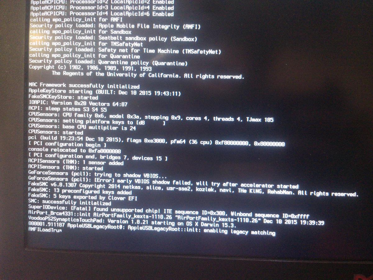

npyadav1 Posted March 14, 2016 Share Posted March 14, 2016 Hello All, Please help me. boot from Clover installation pen drive after some time my laptop is hang Keyboard not work all USB (2.0 & 3.0) port not work. PLEASE HELP ME. Link to comment Share on other sites More sharing options...

npyadav1 Posted March 15, 2016 Author Share Posted March 15, 2016 First of all thank you for replying. I am flow this guide https://osxlatitude.com/index.php?/topic/8506-dell-latitude-inspiron-el-capitan-clover-guide/ Using this Bootpack : Dell_Latitude_E6530_Nvidia-clover_support.zip Yes i am using rear left USB port and 2.0 pandrive System spec Model : Dell Latitude E6530 RAM : 8GB Possessor : Intel i7 3630QM Using Graphic : nVidia NVS 5200M Display resolution : 1920 X 1080 Getting this error. Please check this image :- IMG_20160315_081425.jpg Dell_Latitude_E6530_Nvidia-clover_support.zip Link to comment Share on other sites More sharing options...

Moderators Jake Lo Posted March 16, 2016 Moderators Share Posted March 16, 2016 With that bootpack, it's for Nvidia NVS5200m only. You need to disable Optimus in the BIOS. Link to comment Share on other sites More sharing options...

Moderators Jake Lo Posted March 16, 2016 Moderators Share Posted March 16, 2016 For the Nvidia card, the BIOS version is not critical. Only with HD4000 that you need to keep it at A12 or below. Make sure to disable (uncheck) Optimus for your setup. Link to comment Share on other sites More sharing options...
