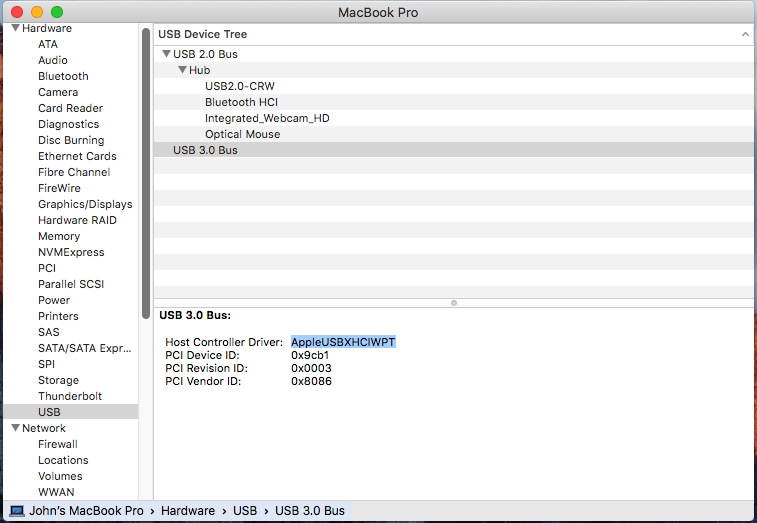

Moderators Jake Lo Posted May 8, 2016 Moderators Share Posted May 8, 2016 Yes, IOReg. Strange I didn't change the DSDT/SSDT except added an additional layout-id for HDAU in DSDT. Try booting without cache. Try adding from here for webcam FakePCIID_XHCIMux.kext & FakePCIID.kext Link to comment Share on other sites More sharing options...
radionoise Posted May 9, 2016 Author Share Posted May 9, 2016 After adding FakePCIID_XHCIMux.kext & FakePCIID.kext files camera started working!!! My card reader also appeared in usb devices list but it's not working (I suppose it won't work at all) Currently I see Nvidia chip in system report with v3 and v4 dsdt attachments. I've made some investigation regarding hdmi sound. I can't hear any sound if I boot laptop with HDMI connected. However, when I reconnect HDMI the sound works OK. Here are two IOreg files with working and not working sound. Almost all is working! Thanks! Is there any chances to make hdmi sound working without reconnecting it after startup? Is there any chances to fix this screen flickering during boot process? Screen flickers only when booting from battery and it stops when [igpu] entries saying that graphics acceleration enabled appear on console. Archive.zipFetching info... Link to comment Share on other sites More sharing options...
