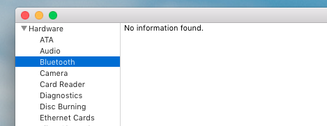

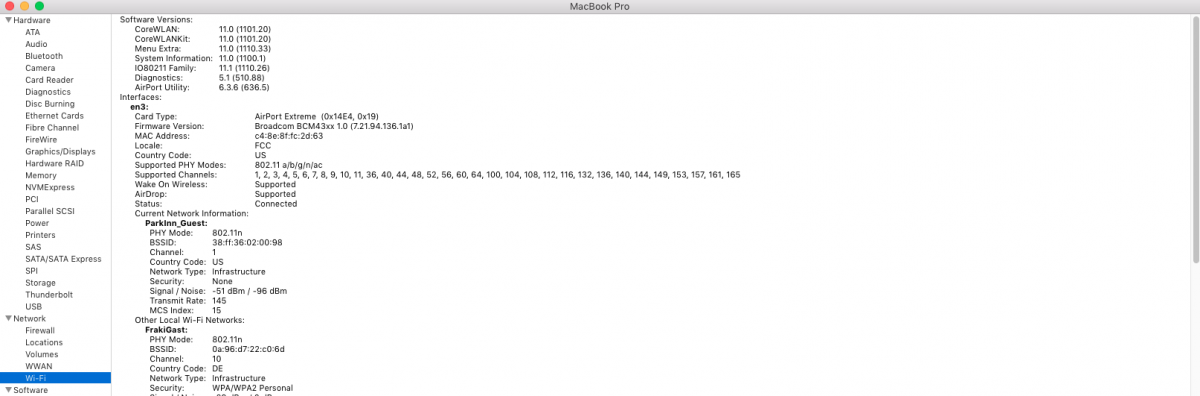

offficial_florin Posted July 20, 2016 Share Posted July 20, 2016 That is the WiFi card I use. The Wifi works perfect, but I can't use Airdrop and Instant Hotspot because Bluetooth does not work. Can anyone tell me how to fix it? The BIOS of my Laptop say there is a Bluetooth device Installed. But why is macOS unable to see it ? This is my Wifi Card: Broadcom BCM94352Z 802.11AC 876Mbps Wireless DW-1560 Bluetooth 4.0 M.2 NGFF I used this guide to Install : https://osxlatitude.com/index.php?/topic/8514-dell-latitude-e7450-el-capitan-clover-uefi-only/ Link to comment Share on other sites More sharing options...
Moderators Jake Lo Posted July 20, 2016 Moderators Share Posted July 20, 2016 Look under USB, does it show there? Link to comment Share on other sites More sharing options...
offficial_florin Posted July 21, 2016 Author Share Posted July 21, 2016 No is Dosnt show. What kext I have to use ? Link to comment Share on other sites More sharing options...
