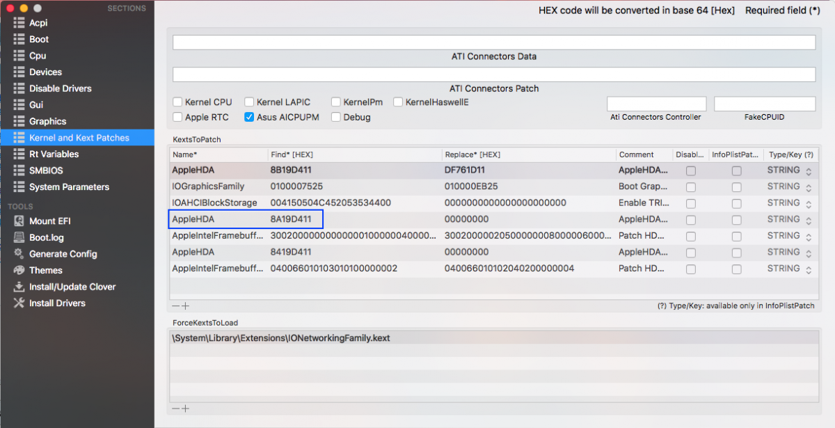

Administrators Hervé Posted November 12, 2016 Administrators Share Posted November 12, 2016 I guess you meant IvyBridge CPU i7-3630QM... Using Clover Configurator tool, try and modify your Clover config.plist as follows: In Graphics tab try layout-id 0x01660003 as opposed to 0x01660004 set DualLink to 1 In Kernel and Kext Patches tab uncheck KernellPm, it's not applicable to IvyBridge platform. You only need AsusAICPUPM for CPU power management. change 8319D411 to 8A19D411 in the 1st entry for AppleHDA patching, still replacing it by 00000000. 8319D411 is not present in the Sierra version of AppleHDA. for IOGraphicsFamily patch (to avoid boot screen glitches), the binary mod should be to replace 0100007525 by 010000EB25 (the replacement you have is for older OS X versions such as Yosemite). You'll have to create your own CPU-specific SSDT with the generator script you've strangely placed in EFI/CLOVER/APCI/patched folder. Normally, the script downloads to home directory from which you can run it. It's the resulting CPU power management-related SSDT that goes alongside the patched DSDT. Link to comment Share on other sites More sharing options...
Moderators Jake Lo Posted November 12, 2016 Moderators Share Posted November 12, 2016 npyadav1 The panic is due to the 10.11 boot glitch patch. Change it to 10.12 bootpatch as Hervé stated above will fix that. for IOGraphicsFamily patch (to avoid boot screen glitches), the binary mod should be to replace 0100007525 by 010000EB25 (the replacement you have is for older OS X versions such as Yosemite). Follow the rest of his advise after you have it booted. They should fix audio and power management. Link to comment Share on other sites More sharing options...

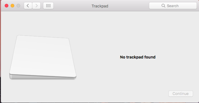

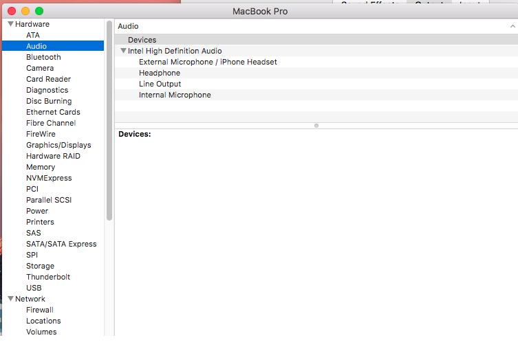

npyadav1 Posted November 13, 2016 Author Share Posted November 13, 2016 Thank you Herve & Jake Lo Kernel panic issue fix. But Audio & trackpad not working. Link to comment Share on other sites More sharing options...
Moderators Jake Lo Posted November 13, 2016 Moderators Share Posted November 13, 2016 As Hervé wrote above, change 8319D411 to 8A19D411 in Config.plist using either Xcode or plistpro editor, not text editor. For trackpad, use Dr. Hurts refined version 4 or 5. Link to comment Share on other sites More sharing options...
npyadav1 Posted November 13, 2016 Author Share Posted November 13, 2016 ok i add VoodooPS2Controller.kext(Release 5) provide by Dr. Hurt in EFI>CLOVER>kexts>Other folder for trackpad And i already change 8319D411 TO 8A19D411 in config.plist using CloverConfigurator. Link to comment Share on other sites More sharing options...
Administrators Hervé Posted November 13, 2016 Administrators Share Posted November 13, 2016 Did you verify the HDEF layout-id? 'should be set to 12 (0x0C) afaik. You may also want to select AppleRTC patch. Could save a little slowness after reboot on BIOS POST completion. But it remains reasonably quick on the E6xxx series compared to the older D series. Link to comment Share on other sites More sharing options...
npyadav1 Posted November 13, 2016 Author Share Posted November 13, 2016 i don't know how to set HDEF layout-id? Link to comment Share on other sites More sharing options...
