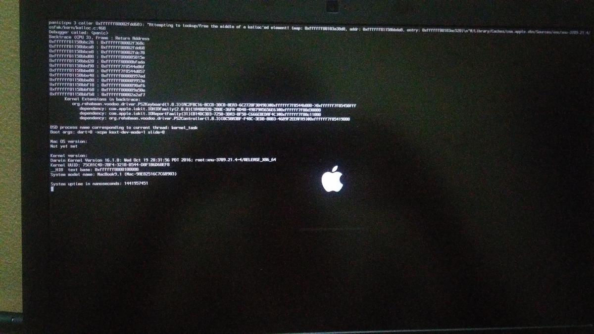

lamcrkh516 Posted December 16, 2016 Share Posted December 16, 2016 I got panic when boot Install MacOS I have config bios all Link to comment Share on other sites More sharing options...
Moderators Jake Lo Posted December 16, 2016 Moderators Share Posted December 16, 2016 Sorry, the voodoops2Controller kext from 5510 is for Synaptics. Remove it and use the ApplePS2Controller from my E7x70 bootpack. Link to comment Share on other sites More sharing options...
