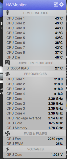

ssprod Posted February 25, 2017 Author Share Posted February 25, 2017 Herve, thanks that worked. How does this look to you? Link to comment Share on other sites More sharing options...
