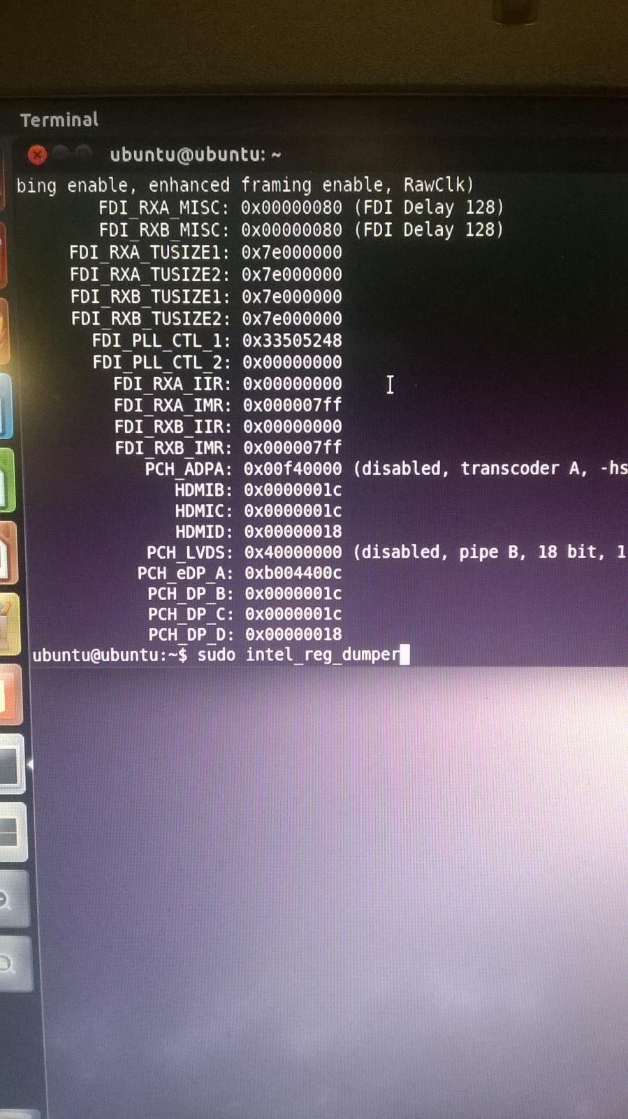

rage75 Posted April 3, 2017 Author Share Posted April 3, 2017 How can I know my connector? If I follow the "Bible"(as you can read in my post previous post) the terminal command : sudo intel_reg_dumper don't give me back any answer... In live with Ubuntu and other live distribution the responce is no command found There's another way for finding my connectors type? Thanks. Link to comment Share on other sites More sharing options...

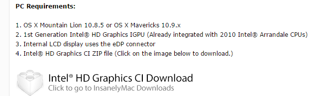

Moderators Jake Lo Posted April 3, 2017 Moderators Share Posted April 3, 2017 You need an older version of Ubuntu like 12.4. But I could 99% be sure you have eDP and not LVDS as does my E6410. Follow the section that pertains to eDP Users Only. Looks like you need to enable Patch VBIOS if you're using Clover or download resolution for Chameleon and then use these file depending on the version of Yosemite you're installing. This will give you partial acceleration http://www.insanelymac.com/forum/files/download/208-1st-gen-intel-hd-graphics-kexts/ Link to comment Share on other sites More sharing options...

rage75 Posted April 3, 2017 Author Share Posted April 3, 2017 Thanks guys, now I see the type using Ubuntu 11.04! eDp.What do you mean exactly for "partial acceleration"?For example now when I use Mirrors the PC needs almost 1 second to open another Desktop windows.And in the"bible" I read that partial acceleration is only for Mountain Lion or Mavericks.I've already select Patch Bios in Clover.Thanks Link to comment Share on other sites More sharing options...
Moderators Jake Lo Posted April 3, 2017 Moderators Share Posted April 3, 2017 Looks like it stop support at 10.9.5 for CI Link to comment Share on other sites More sharing options...
Administrators Hervé Posted April 3, 2017 Administrators Share Posted April 3, 2017 Yup. Nothing further for Yosemite and beyond. That's why I said it was a waste of time. Sorry rage75, but you'll have to accept your laptop just is not worthy for Hackintosh purposes. Not all platforms are... Link to comment Share on other sites More sharing options...
