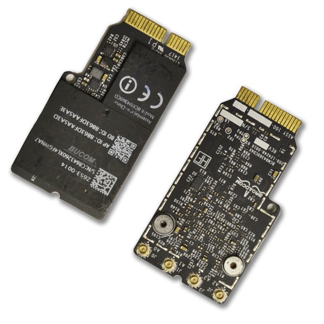

Kjescha Posted June 20, 2017 Author Share Posted June 20, 2017 Oh, didn't notice your update. You told me in a pn that you have AirDrop working on your E6230. Could you please tell which BT card is installed in there? Searching for BCM94360CD I find only cards like the following one, but I am not sure if this is the right one and if it will fit into my E6430. Link to comment Share on other sites More sharing options...
Administrators Hervé Posted June 20, 2017 Administrators Share Posted June 20, 2017 https://osxlatitude.com/index.php?/topic/7554-broadcom-bcm4360cd-80211-ac-wifi-and-bluetooth-combo-card/ Link to comment Share on other sites More sharing options...
Kjescha Posted June 22, 2017 Author Share Posted June 22, 2017 Ok, so AirDrop depends also on a correct wifi card. I will try to rebrand my DW1510 first and report here if that helps. Link to comment Share on other sites More sharing options...
Administrators Hervé Posted June 22, 2017 Administrators Share Posted June 22, 2017 No, it's more a matter of having the correct/supported Bluetooth module in place. https://support.apple.com/en-us/HT203106 Link to comment Share on other sites More sharing options...
