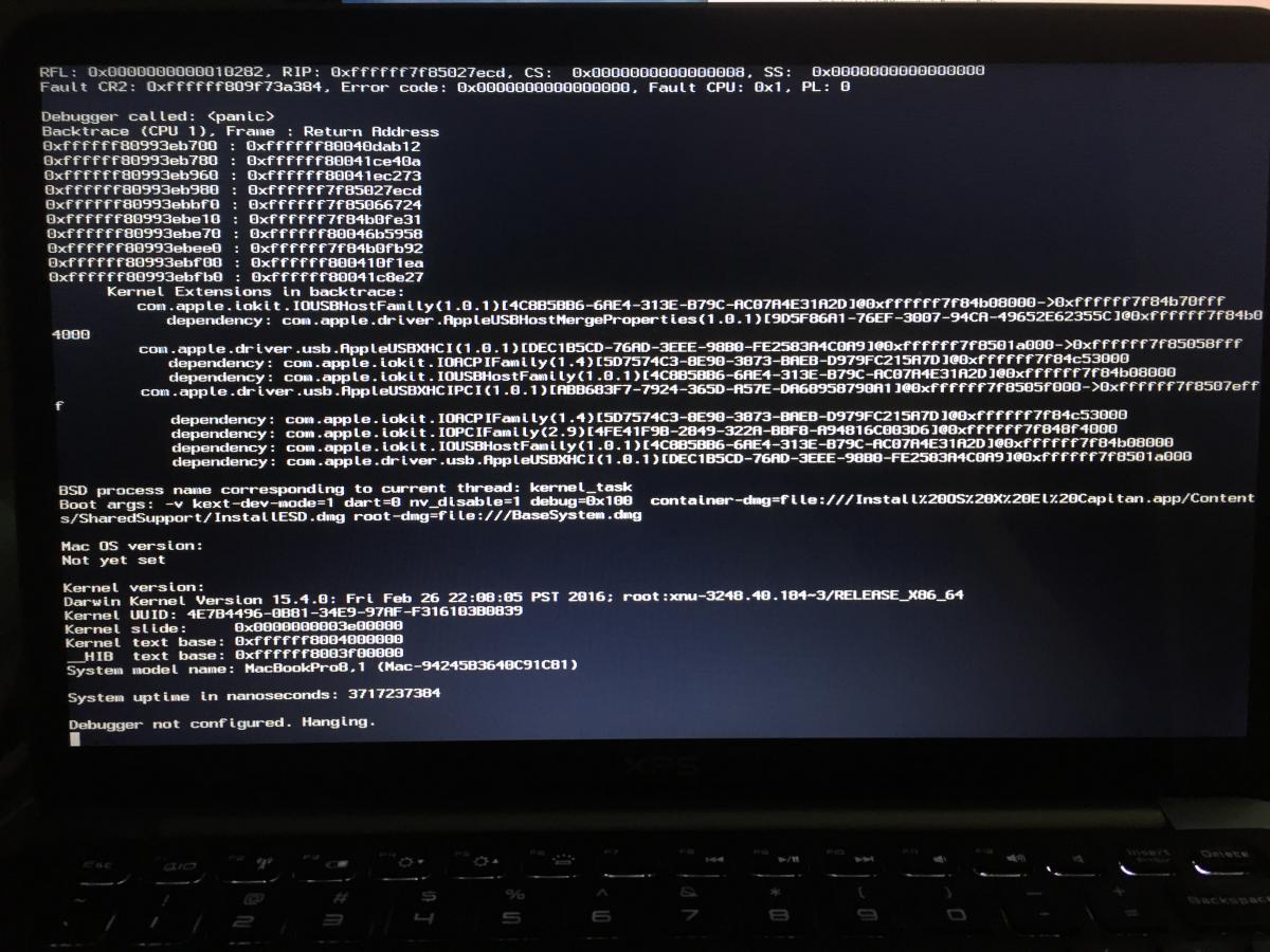

GatorGeek Posted July 5, 2017 Share Posted July 5, 2017 Hello I've recently been given an older Dell XPS L321X laptop and am attempting to install El Capitan on it. Dell XPS L321X, i7-2637m, 4GB RAM, BIOS A04, Intel 3000 GPU @ 1366x768, Samsung SSD PM830 @256GB I've created the legacy bootable USB with Clover r4061 and the El Capitan installer following Rehabman's guide. I am able to get Clover itself to boot fine; however, when the installer begins I get a kernel panic and crash as shown in the attached screenshot. I've attached my EFI folder and config.plist in hopes that someone can help me identify the reason for the crash and get me moving ahead. EFI.zipcopy_plist.txt Thanks in advance for your help. Link to comment Share on other sites More sharing options...
Administrators Bronxteck Posted July 5, 2017 Administrators Share Posted July 5, 2017 you can try removing GenericUSBXHCI.kext from your clover other folder Link to comment Share on other sites More sharing options...

Moderators Jake Lo Posted July 6, 2017 Moderators Share Posted July 6, 2017 This model has Fresco Logic USB 3.0 and there's no support for it. So the last working OS X that will run on it is Yosemite since GenericUSBXHCI stops supporting Fresco after Yosemite. Update: El Capitan /Sierra installation works. Drive must be MBR formatted Use left USB port to install See here for bootpack 1 Link to comment Share on other sites More sharing options...
