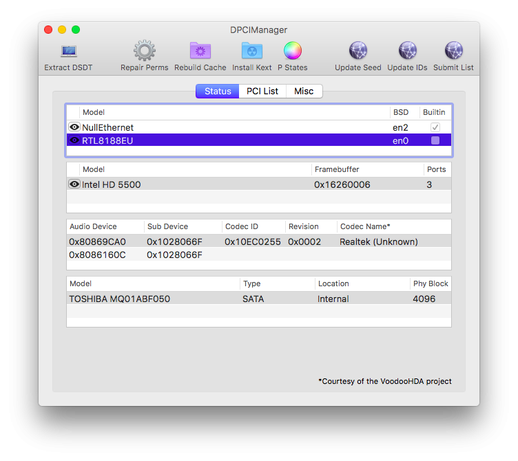

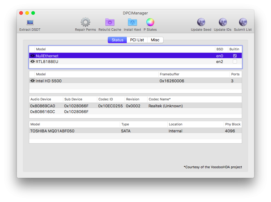

NullEthernet and the SSDT-RMNE.aml were included in the attachment I posted. You just need to place it in /EFI/Clover/kexts/Other. The SSDT-RMNE.aml should go to /EFI/Clover/ACPI/Patched.
Under Network in System Information, you should see Ethernet. If it's not set to en0, then do this
- Go to /Library/Preferences/SystemConfiguration/ and delete these files:
  • CaptiveNetworkSupport
  • com.apple.airport.preferences.plist
  • com.apple.network.eapolclient.configuration.plist
  • NetworkInterfaces.plist
- Go to System Preferences > Network, delete all connection. Then restart
- Go to System Preferences > Network, add your connection again. Starting with Ethernet
