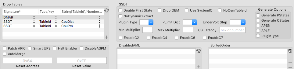

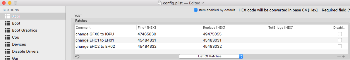

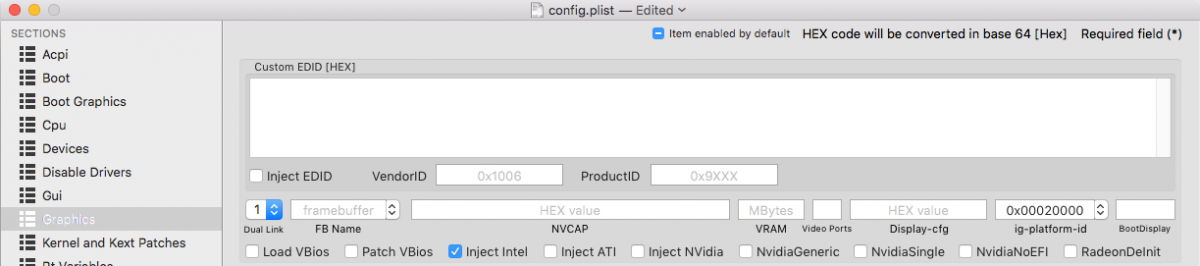

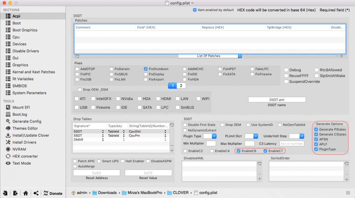

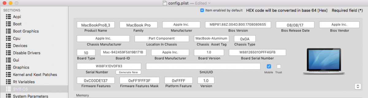

Administrators Hervé Posted December 11, 2017 Administrators Share Posted December 11, 2017 Your IOReg shows a system with dual GPU so if you want to run on the HD3000 iGPU only, you probably ought to disable the nVidia dGPU to begin with. This can be done through DSDT + SSDT patching. You can try the patched files below in your Clover ACPI/patched folder: DSDT.zip SSDT-1.zip Then, on the basis that you have a HiRes built-in LCD, I would recommend that, instead of using the ACPI patching method advocated by black.dragon74, you actually setup HD3000 graphics as follows using Clover Configurator app: adjust your Clover config as follows because the current one is rather erroneous: change GFX0 to iGPU ACPI patch (add the USB controller patches too) inject Intel graphics set SNB layout-id to 0x00020000 set DualLink to 1 set SMBIOS profile to MacBookPro8,3 Once this is done, generate your CPU-specific power management SSDT using Pike R Alpha's well-known generator tool and adjust your Clover config from this: to this: Place the generated SSDT in your Clover ACPI/patched folder and reboot. Hopefully, you'll be all set. Link to comment Share on other sites More sharing options...
yudi.153 Posted December 12, 2017 Author Share Posted December 12, 2017 @ Your IOReg shows a system with dual GPU so if you want to run on the HD3000 iGPU only, you probably ought to disable the nVidia dGPU to begin with. This can be done through DSDT + SSDT patching. You can try the patched files below in your Clover ACPI/patched folder: DSDT.zip SSDT-1.zip Well sir these files when I placed into Clover/acpi/patched, and opened the system preferences->Graphics/displays . I still see both of my GPU's there... So I planned to place the previous DSDT and SSDT files which you and Jake Lo provided me in previous post and it showed me only the Intel GPU in my preferences... attaching those files. Else than that the only part I don't get is the Pike R Alpha's well-known generator tool , how to generate ssdt from this file? and secondly my lcd is 1366x768 so do I need to set DualLink to 1? Link to comment Share on other sites More sharing options...
