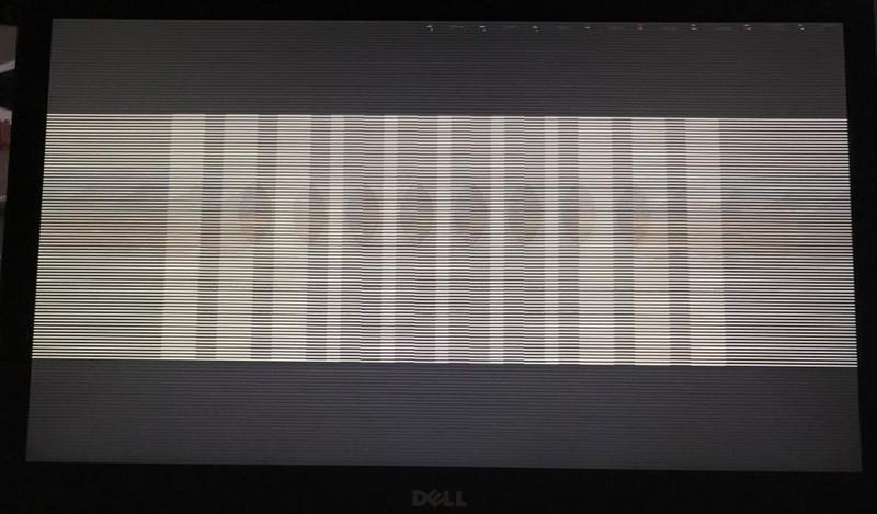

girardpallet Posted October 8, 2017 Share Posted October 8, 2017 Hello,During install , my screen is as attached ...Also after first reboot... i’ M waiting now ..,, EDIT: the screen is ok after sleep and wakeup only. at boot is bad... thank for help Edit 2: so sorry , after reading some other topic about 7440, it looks that after some repair text , everything go well.... i will test and edit .. EDIT 3: repairing and repairing.......but not fixed : garbled screen stays intact. It only goes away after the machine goes to sleep or close and open Lid., any help will be welcome.... Link to comment Share on other sites More sharing options...

Moderators Jake Lo Posted October 20, 2017 Moderators Share Posted October 20, 2017 enable Legacy Option ROMs in the BIOS, will fix the boot garble screen Link to comment Share on other sites More sharing options...

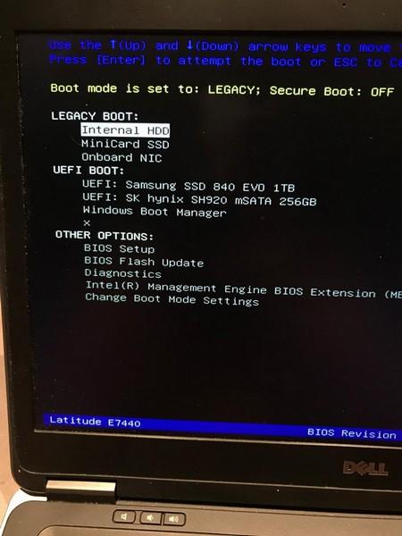

girardpallet Posted October 25, 2017 Author Share Posted October 25, 2017 thanks Jake Lo, it working. but unfortunately i need to press F12 when i start , and drop down to select UEFI , other way it will not start, i have the "invalid partition table "message. Link to comment Share on other sites More sharing options...
Administrators Bronxteck Posted October 25, 2017 Administrators Share Posted October 25, 2017 can you set clover as a UEFI boot path in bios? Link to comment Share on other sites More sharing options...
girardpallet Posted October 25, 2017 Author Share Posted October 25, 2017 it is what i do yesterday, and i was look on the apple.... today it is fine.. sorry i havent re-test before posting . thank it is working now.need to fix the bluetooth now.. i think i will come back soon. Link to comment Share on other sites More sharing options...
