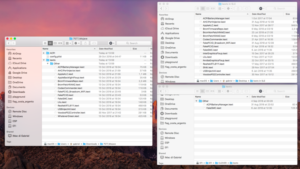

Moderators Jake Lo Posted October 29, 2018 Moderators Share Posted October 29, 2018 Try this one, replace into /EFI/Clover 7577_Mojave.zip Link to comment Share on other sites More sharing options...

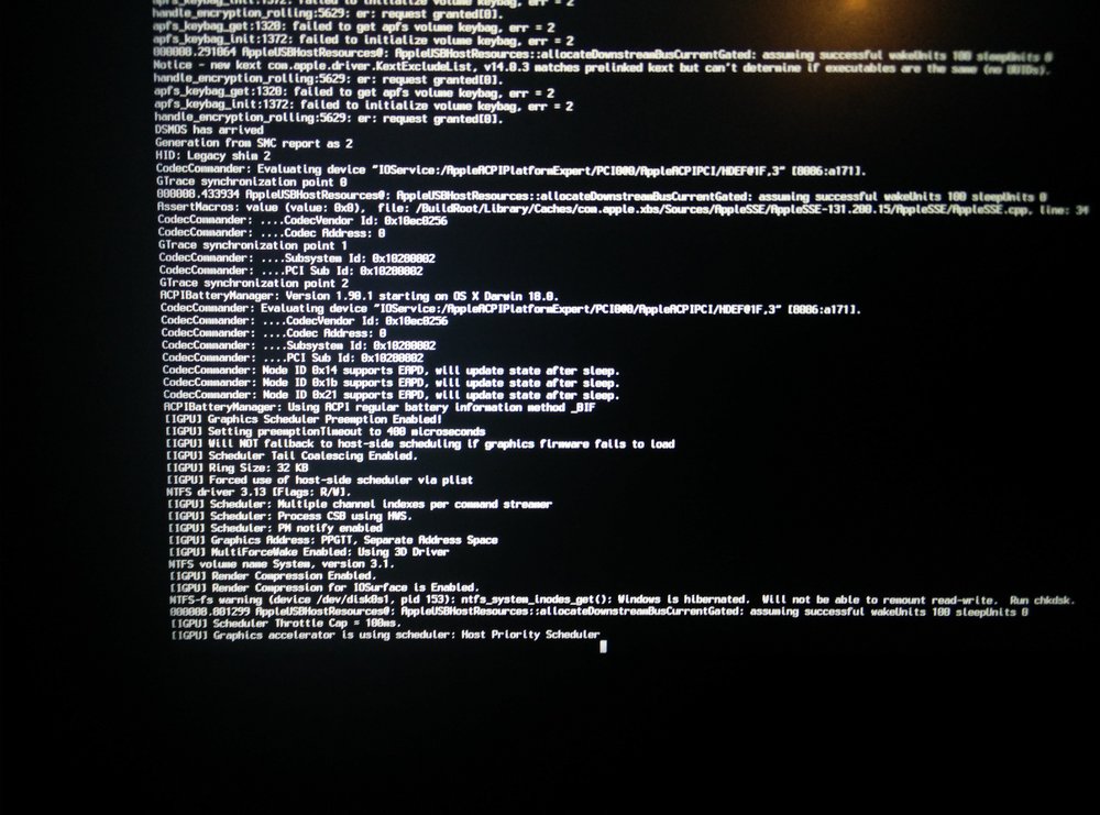

OlegZ Posted October 29, 2018 Share Posted October 29, 2018 Hi, I've tried this last zip. Looks like the driver has started and MacOS runs and makes sounds (I can hear password input sounds) but the text mode remains. Link to comment Share on other sites More sharing options...

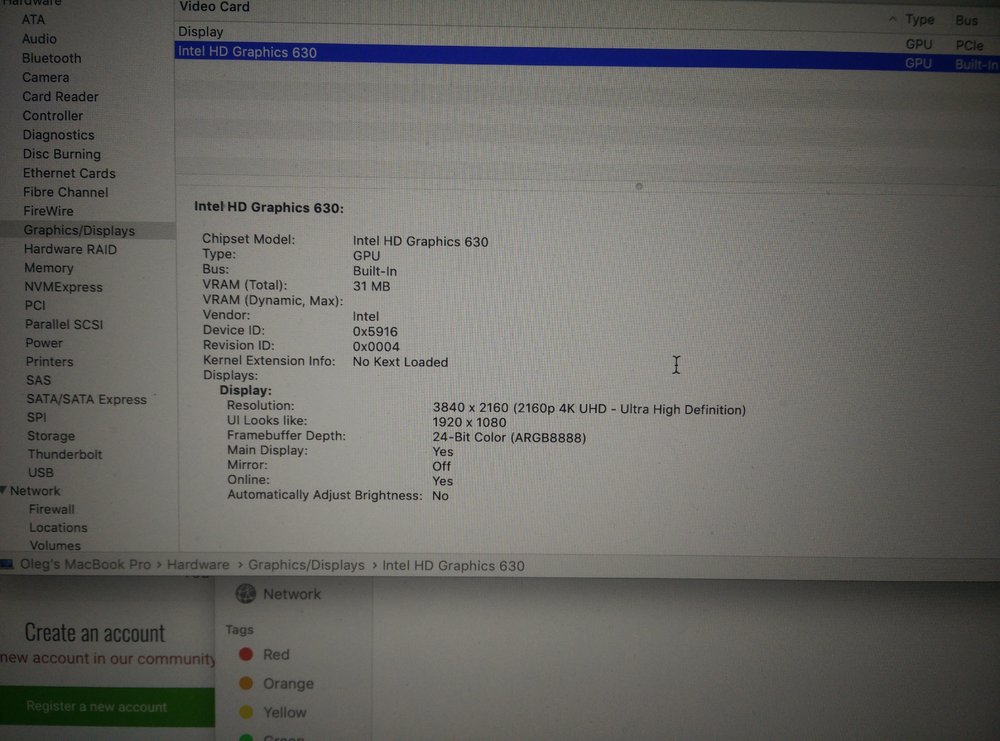

Moderators Jake Lo Posted October 29, 2018 Moderators Share Posted October 29, 2018 set ig-platform-id to 0x12345678 see if you could boot and then check to see if the Geforce is disabled Link to comment Share on other sites More sharing options...
OlegZ Posted October 29, 2018 Share Posted October 29, 2018 I can boot with ig_platform_id=0x12345678 and Geforce is disabled. Link to comment Share on other sites More sharing options...

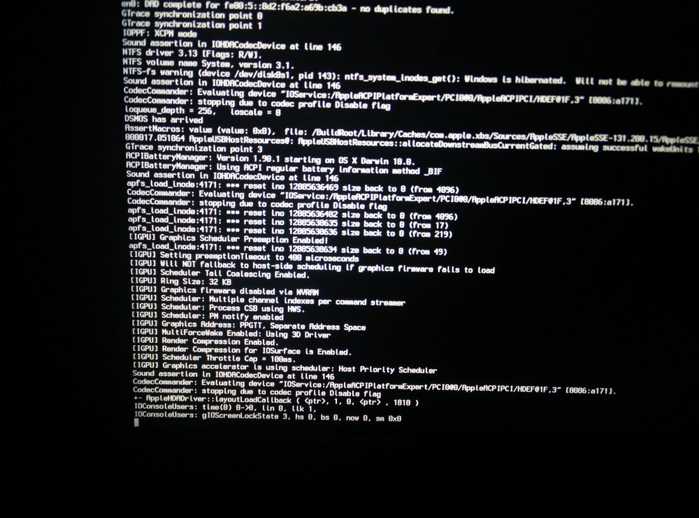

OlegZ Posted October 29, 2018 Share Posted October 29, 2018 Understood, thanks for clarification. Anyway I have tried both ways, I have tried a lot of FakeIDs and platform_ids and nothing works: either that screenshot that I've shown or no acceleration. Do you have more ideas? Link to comment Share on other sites More sharing options...
