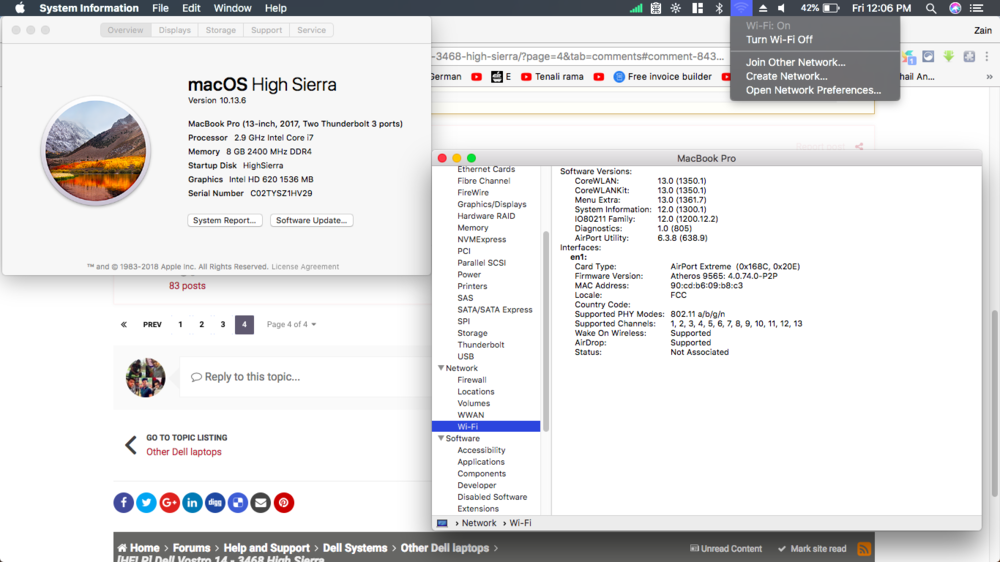

ZainAnjum Posted February 1, 2018 Author Share Posted February 1, 2018 wifi is not working Link to comment Share on other sites More sharing options...
Administrators Bronxteck Posted February 1, 2018 Administrators Share Posted February 1, 2018 is it compatible with osx? it looks like atheros / qualcom. Link to comment Share on other sites More sharing options...
Administrators Hervé Posted February 1, 2018 Administrators Share Posted February 1, 2018 Indeed: Dell Wireless 1810 802.11a/b/g/n/ac based on Atheros QCNFA435/QCA9377 (168c:0042) chip. Most definitely not supported OOB, if at all... Atheros40 kext patch or DSDT injection (for compatibility with supported Atheros model) would need to be tried I guess. Link to comment Share on other sites More sharing options...

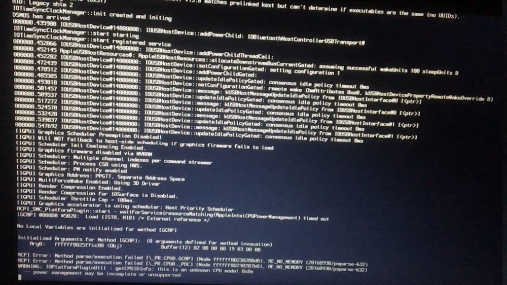

Moderators Jake Lo Posted February 2, 2018 Moderators Share Posted February 2, 2018 Follow instructions from here to debug issue gen_debug -sysprofile Link to comment Share on other sites More sharing options...
