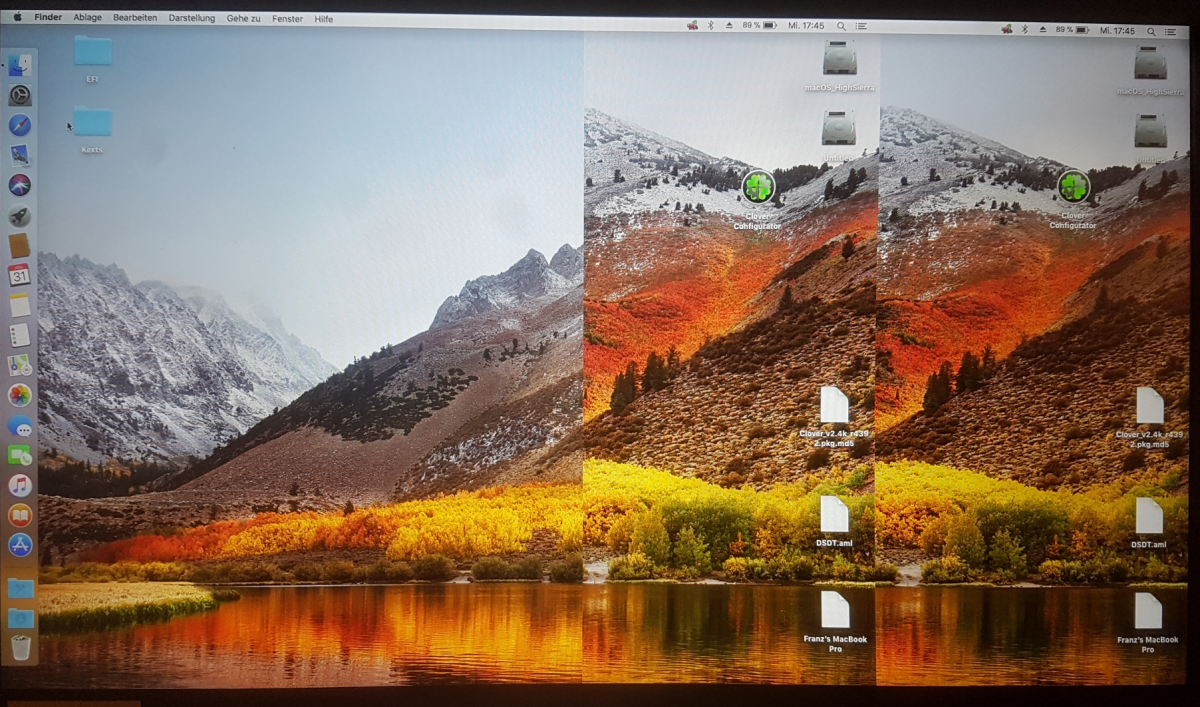

fmac Posted February 11, 2018 Share Posted February 11, 2018 Hallo my hardware specs : Dell Latitude 5580, Bios ver 1.7.5 Intel® Core i5-7440HQ CPU @ 2.80GHz, IntelHD 630, Device ID: 0x591b (Kabylake mobile ?) Display 1920 x 1080 8GBRam, SATA HDD 256GB Liteon CV3 Clover 4411, UEFI macOS 10.13.3 High Sierra on usb disk thanks to all here found many tips and tricks macOS High Sierra 10.13.3 is running, but have some troubles audio is not working, (devices are not recognised) trackpad not working (voodooi2c gives errors) wifi (its intel) sleep is partially working (after sleep no usb and bad video (Desktop.png)) hdmi out thanks for your tips Dell_5580.zip origin.zip Other.zip Link to comment Share on other sites More sharing options...
Moderators Jake Lo Posted February 12, 2018 Moderators Share Posted February 12, 2018 Intel Wifi won't be supported, will need to be replaced with maybe DW1560 or DW1830 For Display issue after sleep, try this EDID fix I patched the files for you, remove some of the unnecessary kexts as well. Can't guarantee the touchpad will work, but it's a first attempt. Replace the attached contents into /EFI/Clover Hopefully fix audio. 5580_HS.zip 1 Link to comment Share on other sites More sharing options...
