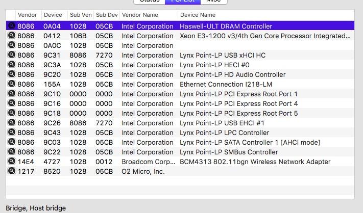

Gul Mehru Posted March 19, 2018 Author Share Posted March 19, 2018 BCM4313 is the wifi card i think it is combo wifi and bluetooth i am using TP_link usb wifi device so just need to use bluetooth from BCM4313 device thanks Link to comment Share on other sites More sharing options...
Moderators Jake Lo Posted March 19, 2018 Moderators Share Posted March 19, 2018 what's the product/vendor ID? Link to comment Share on other sites More sharing options...
Administrators Hervé Posted March 19, 2018 Administrators Share Posted March 19, 2018 Check your SysProfiler for an eventual Bluetooth device under USB. If the card is combo indeed, the Bluetooh module should be listed there, whether it works or not. Link to comment Share on other sites More sharing options...
Gul Mehru Posted March 20, 2018 Author Share Posted March 20, 2018 pci list Link to comment Share on other sites More sharing options...
