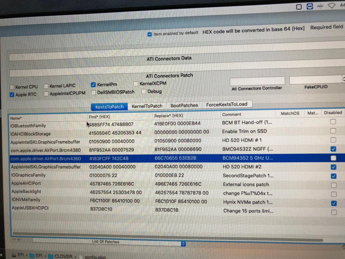

Edit Config.plist with Clover Configurator
Under kernel and kexts patches, look for all instances
AirPortBrcm4360
replace with
com.apple.driver.AirPort.Brcm4360
