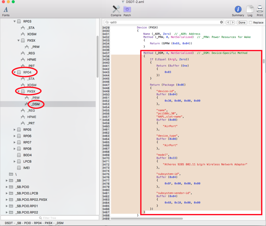

cyrhex Posted June 22, 2018 Author Share Posted June 22, 2018 4 hours ago, Allan said: Look how can i add this on my dsdt? Link to comment Share on other sites More sharing options...
Moderators Jake Lo Posted June 22, 2018 Moderators Share Posted June 22, 2018 You need to create a _DSM method for each device and you need to determine the location of the device. You'll need know how to patch DSDT and read IORegistry to determine the location of the device. example: For my Wifi card, looking through IORegistryExplorer.app, I'll find it under RP04->PXSX So I need to create a _DSM Method in my DSDT under RP04/PXSX 1 Link to comment Share on other sites More sharing options...
