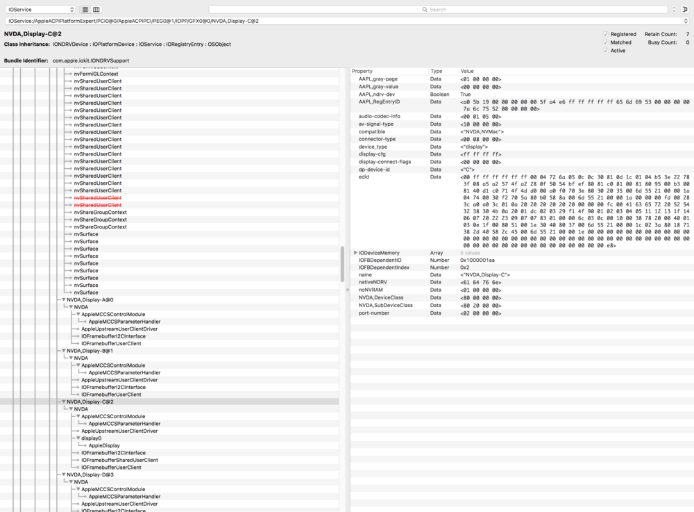

PaintArm Posted August 9, 2018 Author Share Posted August 9, 2018 I certainly can the next time it happens. I am connected over DP. When I was on 10.13.5 it worked fine. After the upgrade to 10.13.6 just intermittent. I was looking through the IOReg and it references the connector type as HDMI (<00 08 00 00>) and further down it references the dp device as C. I don’t know how to change the connector type to <00 04 00 00> which will identify it as a DP connector not HDMI. Maybe that would help. Also all references in IOReg for device is for HDAU are <00 07 00 00> but I think I need it to be <00 03 00 00> which makes the audio work natively with AppleHDA over the HD4600 DP port. Am I thinking on the right lines or no where near? Link to comment Share on other sites More sharing options...
