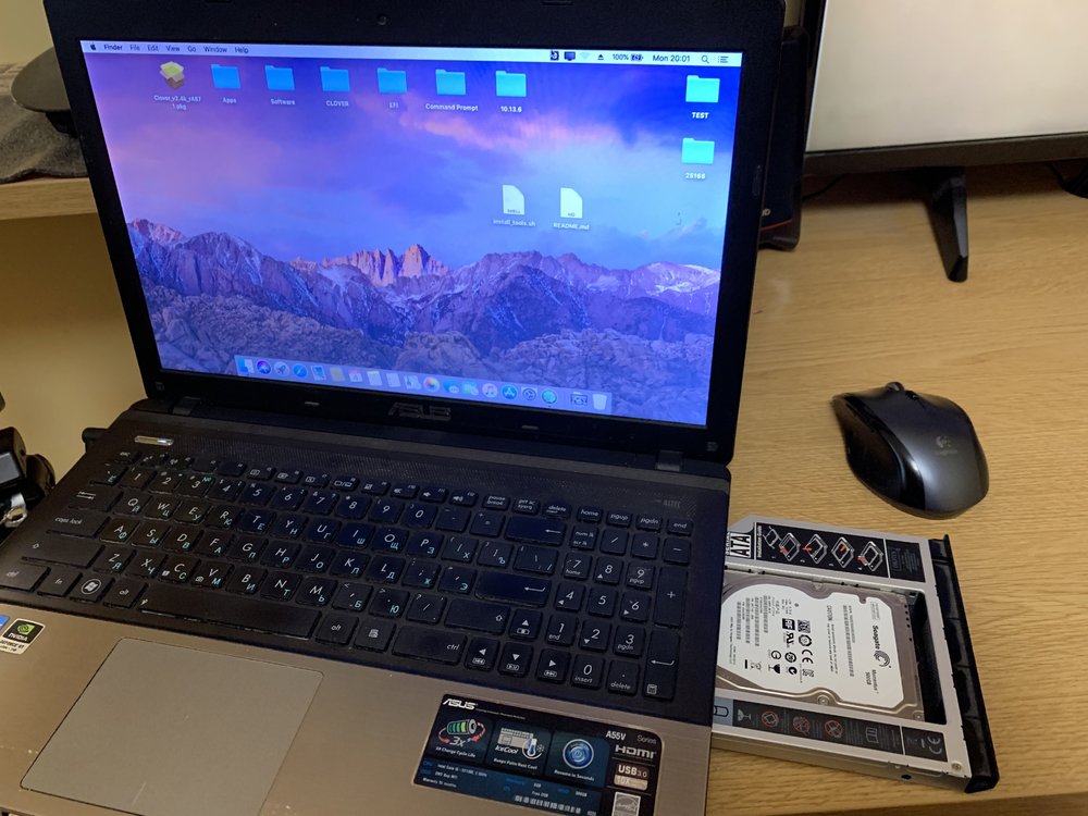

ManiaKsLV Posted March 4, 2019 Author Share Posted March 4, 2019 2 minutes ago, Jake Lo said: AR9485 has little to no support and are hits and misses, more misses. See here. It's not a recommended device I can see that... I can see networks but can't connect. Today i'll try find some Mini PCIe wifi card. What wifi card would you prefer? I can get spare parts from these laptops. + can i make dual boot now with WIN10 when i have only MacOS on my ssd... i added 2nd drive HDD in DVD drive place. So 2 seperate drives one SSD with MacOS and other HDD with WIN 10. Can you give some advice because i don't want screw up macos install but i will not touch ssd anymore only for MacOS purpose. For WIN 10 i leave HDD. Link to comment Share on other sites More sharing options...
Moderators Jake Lo Posted March 4, 2019 Moderators Share Posted March 4, 2019 DW1550 or something from the link I provided above. Stay away from Atheros, not longer supported in Mojave if you plan to upgrade later. Yes, dual boot is possible. Check out the Dual Boot instruction from this guide 1 Link to comment Share on other sites More sharing options...

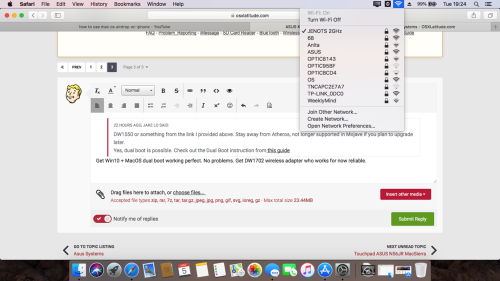

ManiaKsLV Posted March 5, 2019 Author Share Posted March 5, 2019 22 hours ago, Jake Lo said: DW1550 or something from the link I provided above. Stay away from Atheros, not longer supported in Mojave if you plan to upgrade later. Yes, dual boot is possible. Check out the Dual Boot instruction from this guide Get Win10 + MacOS dual boot working perfect. No problems. Get DW1702 wireless adapter who works for now reliable. Thanks a lot for leads to successful installation and set-up. @Jake Lo Link to comment Share on other sites More sharing options...

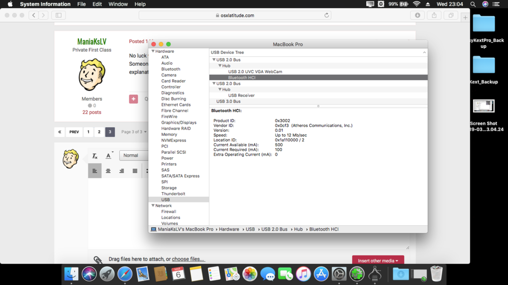

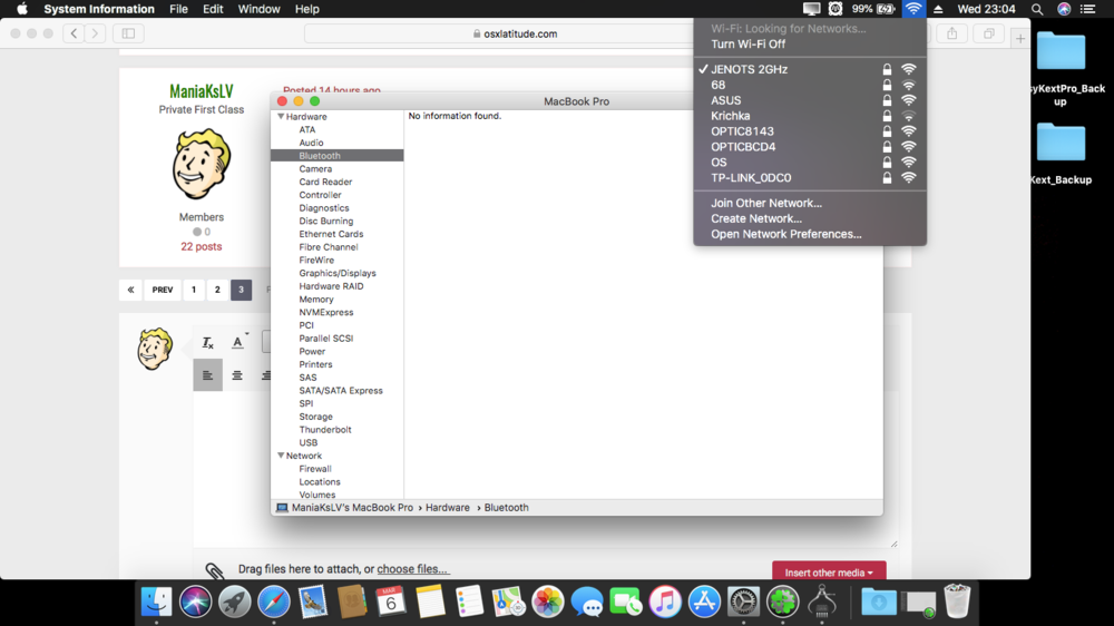

ManiaKsLV Posted March 6, 2019 Author Share Posted March 6, 2019 No luck with DW1702 i do something wrong... Someone have experience enabling Bluetooth (AR3011) and Wi-Fi (AR9285) combo card BT connection with depth explanation because wifi is working. Link to comment Share on other sites More sharing options...
ManiaKsLV Posted March 6, 2019 Author Share Posted March 6, 2019 Still can't get DW 1702 working BT. Wifi works thats good. Can someone share his experience enabling DW1702 BT in HIGH SIERRA? Link to comment Share on other sites More sharing options...
