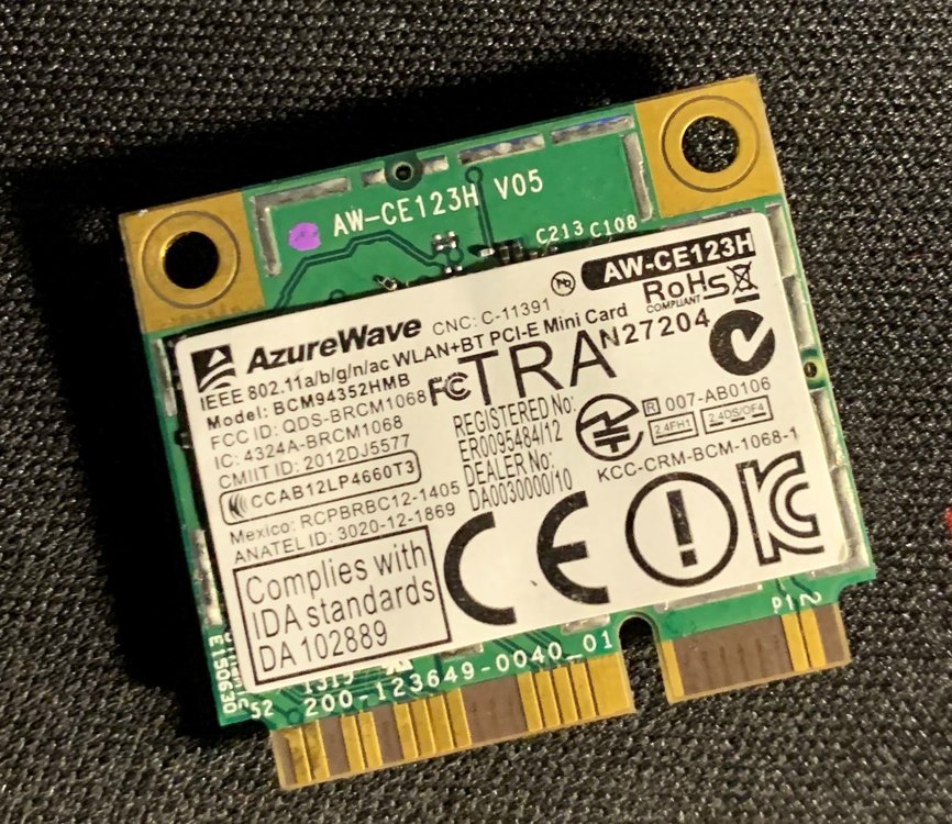

ManiaKsLV Posted March 10, 2019 Author Share Posted March 10, 2019 Ok now i have AW-CE123H Bluetooth works but wifi don't.... what now? When boot in win 10 all works even 5ghz wifi and bluetooth now should make wifi work. what should i start with... how to know kext to delete from previous patch by date? Link to comment Share on other sites More sharing options...

ManiaKsLV Posted March 10, 2019 Author Share Posted March 10, 2019 @Hervé bcm94352hmb is the chip. Ok i will do that. Link to comment Share on other sites More sharing options...
Administrators Hervé Posted March 10, 2019 Administrators Share Posted March 10, 2019 Congratulations, you've identified the chipset. What's next? Link to comment Share on other sites More sharing options...
ManiaKsLV Posted March 10, 2019 Author Share Posted March 10, 2019 @Hervé 1. I deleted all kext what i use before with DW1702. 2. bcm94352hmb -> AW-CE123H is in supported wifi card list 3.i want to make this wifi and bt work. 4. i don't know whats next.... Link to comment Share on other sites More sharing options...
Administrators Hervé Posted March 10, 2019 Administrators Share Posted March 10, 2019 Picture not necessary, I got it 1st time... I'm sure you'll find a few pointers in the inventory's entry for that model (I believe it says a little more than just plain "supported"...). Then I invite you to consult the many threads related to BCM4352/BCM94352/AW-CE123H you'll find in the Wireless section of the forum. You can do it! Link to comment Share on other sites More sharing options...
ManiaKsLV Posted March 10, 2019 Author Share Posted March 10, 2019 Yes. But my experience in this is close to 0. AzureWave AW-CE123H ½Min PCIe 14e4-43b1 BCM4352 A/B/G/N/AC Y Y Y N DSDT/Brcm4360 patch DSDT/Brcm4360 patch i don''t know what is that. + i will try find everything i need i have watched lots of YT videos looked lots of posts but non of them worked for me so far.. still trying Link to comment Share on other sites More sharing options...

Administrators Hervé Posted March 10, 2019 Administrators Share Posted March 10, 2019 You're not wasting my time, it's just that I'm a great believer of educating/experimenting/failing/retrying/succeeding, not of spoon-feeding... DSDT/Brcm4360 patch means exactly that: you either patch your DSDT or the Brcm4360 kext. If you read the inventory further down, you'll see what patching the DSDT or the kext means: NB: Patching means adding the PCI ids of the listed card to the Info.plist file found inside the listed kext. In rare cases, binary patching may also be necessary. For some cards, DSDT Patching can be a suitable and permanent alternative to kext patching (no need to repatch a kext after OS X updates and upgrades or new installations). Further down the post, there is an example of DSDT patching for Broadcom cards. That's what you could do for your AW-CE123H (and what I would advocate you do), the alternative being to patch the Brcm4360 kext as listed in the various BCM4352 threads found in our wireless forum section. This kext patching may also be done through Clover. Link to comment Share on other sites More sharing options...
