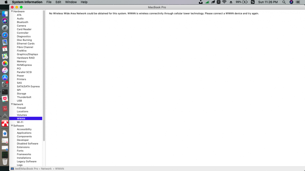

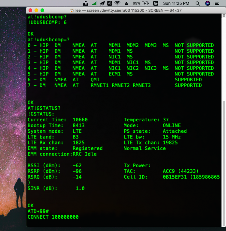

antizo Posted May 5, 2019 Share Posted May 5, 2019 On windows and linux , It works well ,but on macos I can't use it to connect the internet. Here is the Info.plist of Legacy_Sierra_QMI_10.13.kext that I have used. Reveal hidden contents <?xml version="1.0" encoding="UTF-8"?> <!DOCTYPE plist PUBLIC "-//Apple//DTD PLIST 1.0//EN" "http://www.apple.com/DTDs/PropertyList-1.0.dtd"> <plist version="1.0"> <dict> <key>BuildMachineOSBuild</key> <string>16B2657</string> <key>CFBundleDevelopmentRegion</key> <string>English</string> <key>CFBundleIdentifier</key> <string>com.apple.driver.LegacySierraQMI</string> <key>CFBundleInfoDictionaryVersion</key> <string>6.0</string> <key>CFBundleName</key> <string>Legacy Sierra QMI</string> <key>CFBundlePackageType</key> <string>KEXT</string> <key>CFBundleShortVersionString</key> <string>1.4.0</string> <key>CFBundleSignature</key> <string>????</string> <key>CFBundleSupportedPlatforms</key> <array> <string>MacOSX</string> </array> <key>CFBundleVersion</key> <string>1.4.0</string> <key>IOKitPersonalities</key> <dict> <key>0x199/0x68a2 MC7710</key> <dict> <key>CFBundleIdentifier</key> <string>com.apple.driver.AppleUSBHostMergeProperties</string> <key>IOClass</key> <string>AppleUSBHostMergeProperties</string> <key>IOProviderClass</key> <string>IOUSBHostDevice</string> <key>IOProviderMergeProperties</key> <dict> <key>DeviceModemOverrides</key> <dict> <key>ConnectionPersonality</key> <string>Sierra GSM Personality</string> <key>ConnectionScript</key> <string>WWAN.ccl</string> <key>DeviceContextID</key> <string>1</string> <key>DeviceModel</key> <string>GSM</string> <key>DeviceVendor</key> <string>Sierra Wireless</string> </dict> <key>DevicePPPOverrides</key> <dict> <key>LCPMTU</key> <integer>1450</integer> </dict> <key>InfoCommands</key> <dict> <key>ATCommands</key> <dict> <key>DirectoryNumber</key> <string>+cnum</string> <key>IMEI</key> <string>+cgsn</string> <key>IMSI</key> <string>+cimi</string> <key>Manufacturer</key> <string>+cgmi</string> <key>Model</key> <string>+cgmm</string> <key>ModemSW</key> <string>+cgmr</string> <key>Serial#</key> <string>+gsn</string> </dict> <key>HiddenProperties</key> <dict> <key>CommandPortBaseName</key> <string>wwan</string> <key>ControlPortBaseName</key> <string>wwan</string> <key>DataPortBaseName</key> <string>wwan</string> <key>StatusType</key> <string>CellPhoneGSM</string> </dict> </dict> <key>Initializing</key> <true/> <key>InterfaceMapping</key> <dict> <key>0</key> <dict> <key>name</key> <string>wwanDM</string> </dict> <key>2</key> <dict> <key>name</key> <string>wwanGPS</string> </dict> <key>3</key> <dict> <key>name</key> <string>wwan</string> </dict> </dict> <key>WWAN</key> <true/> </dict> <key>bcdDevice</key> <integer>6</integer> <key>idProduct</key> <integer>26786</integer> <key>idVendor</key> <integer>4505</integer> </dict> </dict> <key>OSBundleLibraries</key> <dict> <key>com.apple.driver.AppleUSBHostMergeProperties</key> <string>1.0</string> <key>com.apple.iokit.IOUSBHostFamily</key> <string>1.0.1</string> <key>com.apple.kpi.iokit</key> <string>8.0</string> <key>com.apple.kpi.libkern</key> <string>9.0.0</string> </dict> <key>OSBundleRequired</key> <string>Root</string> </dict> </plist> __________________________________ And other information Link to comment Share on other sites More sharing options...
