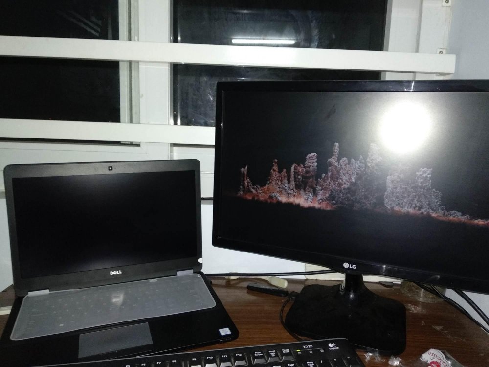

huyhoang Posted October 19, 2019 Share Posted October 19, 2019 Hi All, I have an issue, when i plug in HDMI cable, my laptop screen not show everything, but external screen is show ok. I do not why?, Please can you help me fix this, . i have use guide to install, everything is working ok, but when i plugin HDMI cable it is working not correct : DELL LATITUDE E5470 CPU: Core i5 6440HQ 2,6GHz Intel Graphics 530 Full HD 1920 x 1080 Thanks All SO MUCH Link to comment Share on other sites More sharing options...
Administrators Bronxteck Posted October 19, 2019 Administrators Share Posted October 19, 2019 have you tried closing the lid to the laptop then opening it again when this occurs? 1 Link to comment Share on other sites More sharing options...

huyhoang Posted October 19, 2019 Author Share Posted October 19, 2019 @Bronxteck When i restart my laptop. it is working not correct again, and i close and open my laptop screen, it show all thing good on two screen, I do not know why i have to do this :), please can you help me understand it, and how to fix it Thanks so much Link to comment Share on other sites More sharing options...
Administrators Bronxteck Posted October 19, 2019 Administrators Share Posted October 19, 2019 i guess it needs the display to be reinitialized. why i do not know but display port tends to have this quirk. 1 Link to comment Share on other sites More sharing options...
huyhoang Posted October 19, 2019 Author Share Posted October 19, 2019 You have give me a best solution now, i have spend three days to research, find, and tried many time but not success. If you find some solution to solve it, please can you notify me Thank you to supported me Link to comment Share on other sites More sharing options...
Moderators Jake Lo Posted October 19, 2019 Moderators Share Posted October 19, 2019 This was noted in my E7x70 guide. It only happens on clean boot. If system has slept once, it won't happen. You could try adding EDID, it worked on my E7270 but not my E7470. You don't really need to put it to sleep, just close lid, the external monitor comes on as primary. You can then open the lid and it'll swap back. 1 Link to comment Share on other sites More sharing options...
