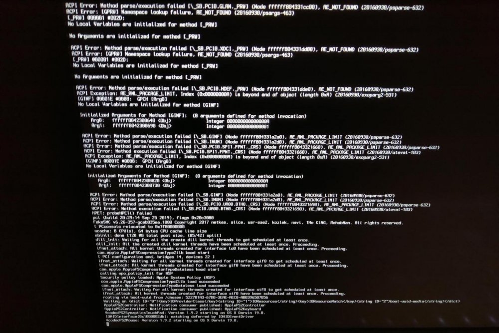

marv Posted October 21, 2019 Share Posted October 21, 2019 I followed the Catalina section of the guide to prepare a boot medium for my Dell Latitude 7490 (i7-8650U). I also configured the BIOS as per recommendation. Unfortunately I cannot successfully boot into the installer. After some time I get scrambled characters and the stop sign. Any hints of what I can do? Here are screenshots of what I got: And the output of lspci on Linux: 00:00.0 Host bridge: Intel Corporation Xeon E3-1200 v6/7th Gen Core Processor Host Bridge/DRAM Registers (rev 08) 00:02.0 VGA compatible controller: Intel Corporation UHD Graphics 620 (rev 07) 00:04.0 Signal processing controller: Intel Corporation Skylake Processor Thermal Subsystem (rev 08) 00:14.0 USB controller: Intel Corporation Sunrise Point-LP USB 3.0 xHCI Controller (rev 21) 00:14.2 Signal processing controller: Intel Corporation Sunrise Point-LP Thermal subsystem (rev 21) 00:15.0 Signal processing controller: Intel Corporation Sunrise Point-LP Serial IO I2C Controller #0 (rev 21) 00:15.1 Signal processing controller: Intel Corporation Sunrise Point-LP Serial IO I2C Controller #1 (rev 21) 00:15.2 Signal processing controller: Intel Corporation Sunrise Point-LP Serial IO I2C Controller #2 (rev 21) 00:15.3 Signal processing controller: Intel Corporation Sunrise Point-LP Serial IO I2C Controller #3 (rev 21) 00:16.0 Communication controller: Intel Corporation Sunrise Point-LP CSME HECI #1 (rev 21) 00:17.0 SATA controller: Intel Corporation Sunrise Point-LP SATA Controller [AHCI mode] (rev 21) 00:1c.0 PCI bridge: Intel Corporation Sunrise Point-LP PCI Express Root Port (rev f1) 00:1c.2 PCI bridge: Intel Corporation Sunrise Point-LP PCI Express Root Port (rev f1) 00:1c.4 PCI bridge: Intel Corporation Sunrise Point-LP PCI Express Root Port #5 (rev f1) 00:1f.0 ISA bridge: Intel Corporation Sunrise Point LPC Controller/eSPI Controller (rev 21) 00:1f.2 Memory controller: Intel Corporation Sunrise Point-LP PMC (rev 21) 00:1f.3 Audio device: Intel Corporation Sunrise Point-LP HD Audio (rev 21) 00:1f.4 SMBus: Intel Corporation Sunrise Point-LP SMBus (rev 21) 00:1f.6 Ethernet controller: Intel Corporation Ethernet Connection (4) I219-LM (rev 21) 01:00.0 Unassigned class [ff00]: Realtek Semiconductor Co., Ltd. RTS525A PCI Express Card Reader (rev 01) 02:00.0 Network controller: Intel Corporation Wireless 8265 / 8275 (rev 78) 03:00.0 PCI bridge: Intel Corporation JHL6340 Thunderbolt 3 Bridge (C step) [Alpine Ridge 2C 2016] (rev 02) 04:00.0 PCI bridge: Intel Corporation JHL6340 Thunderbolt 3 Bridge (C step) [Alpine Ridge 2C 2016] (rev 02) 04:01.0 PCI bridge: Intel Corporation JHL6340 Thunderbolt 3 Bridge (C step) [Alpine Ridge 2C 2016] (rev 02) 04:02.0 PCI bridge: Intel Corporation JHL6340 Thunderbolt 3 Bridge (C step) [Alpine Ridge 2C 2016] (rev 02) 05:00.0 System peripheral: Intel Corporation JHL6340 Thunderbolt 3 NHI (C step) [Alpine Ridge 2C 2016] (rev 02) 06:00.0 PCI bridge: Intel Corporation JHL6540 Thunderbolt 3 Bridge (C step) [Alpine Ridge 4C 2016] (rev 02) 07:00.0 PCI bridge: Intel Corporation JHL6540 Thunderbolt 3 Bridge (C step) [Alpine Ridge 4C 2016] (rev 02) 07:01.0 PCI bridge: Intel Corporation JHL6540 Thunderbolt 3 Bridge (C step) [Alpine Ridge 4C 2016] (rev 02) 07:02.0 PCI bridge: Intel Corporation JHL6540 Thunderbolt 3 Bridge (C step) [Alpine Ridge 4C 2016] (rev 02) 07:03.0 PCI bridge: Intel Corporation JHL6540 Thunderbolt 3 Bridge (C step) [Alpine Ridge 4C 2016] (rev 02) 07:04.0 PCI bridge: Intel Corporation JHL6540 Thunderbolt 3 Bridge (C step) [Alpine Ridge 4C 2016] (rev 02) 08:00.0 USB controller: Fresco Logic FL1100 USB 3.0 Host Controller (rev 10) 0a:00.0 USB controller: Fresco Logic FL1100 USB 3.0 Host Controller (rev 10) Link to comment Share on other sites More sharing options...
Administrators Hervé Posted October 21, 2019 Administrators Share Posted October 21, 2019 Try without the patched DSDT; either remove it from ACPI/patched folder or select BIOS.aml table from Clover main menu->Options->ACPI configs when Clover boots. Link to comment Share on other sites More sharing options...
marv Posted October 21, 2019 Author Share Posted October 21, 2019 Thanks, deleting ACPI/patches/DSDT.aml helped. Link to comment Share on other sites More sharing options...
