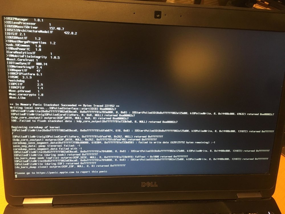

rytmdoktorn Posted January 31, 2020 Share Posted January 31, 2020 Installed Catalina 10.15.2 a couple of weeks ago following Jake Lo's guide. It was working flawless. Now that I saw that the update to 10.15.3 upgrade was like a walk in the park as long as I updated Clover, kexts and repaired permissions and rebuild cache I decided to take my chances. So, I checked Clover, was latest version already. Updated a few kexts with the help of Kext Updater app. (For some reason it wouldn't boot if I moved BrcmFirmwareRepo.kext and BrcmPatchRAM2.kext. I now have BrcmFirmwareData.kext and BrcmPatchRAM3.kext in my "Other" folder.) So, even though I have all my kexts in the EFI partition , I ran the following just in case: sudo chmod -Rf 755 /L*/E* sudo chown -Rf 0:0 /L*/E* sudo chmod -Rf 755 /S*/L*/E* sudo chown -Rf 0:0 /S*/L*/E* sudo touch -f /L*/E* sudo touch -f /S*/L*/E* sudo kextcache -Boot -U / The upgrade started and rebooted, then got stuck. I can still get in to the 10.15.2 installation so I set the boot mode to verbose and restarted. Now it tells me: ** In Memory Panic Stackshot Succeded ** Bytes Traced 30512 ** Link to comment Share on other sites More sharing options...

rytmdoktorn Posted January 31, 2020 Author Share Posted January 31, 2020 Some unnecessary? I tried disabling them all, no luck. Tried disabling some random ones, no luck. Tried the option to boot without injected kexts, no luck. When booting in safe mode I get some more info on the screen if it's of any help? Link to comment Share on other sites More sharing options...

rytmdoktorn Posted January 31, 2020 Author Share Posted January 31, 2020 Sorry to say, still no luck. All kexts but VirtualSMC disabled, same output. Boot option -igfxvesa, same thing. Will try to do a complete reinstall with 10.15.3 instead on another disk and see if that helps. Will let you know in a few hours or tomorrow. Thanks for your superb guide on installing on this computer! I remember my first hack, it took weeks to get it working right. Link to comment Share on other sites More sharing options...
rytmdoktorn Posted February 2, 2020 Author Share Posted February 2, 2020 I tried a fresh install, same thing. I spent countless hours yesterday trying to figure it out, nothing. So I thought, "What is different with my setup compared to a default machine?" Oh... the wireless card (DW1820A). Disabled it in BIOS and... Voila! The update installed just fine! Enabled it again and still booting just fine. Link to comment Share on other sites More sharing options...
