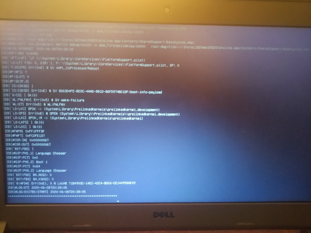

theawesomerb Posted June 2, 2020 Author Share Posted June 2, 2020 Hello, It took me quite a time to download the files olarilla, i followed the tutorial , when i boot it shows me this screen and takes ages then, i rebooted and chosed the config2 , same thing : Also i can't edit the usb key to put your files of 3350. what did go wrong ?? Link to comment Share on other sites More sharing options...
Moderators Jake Lo Posted June 2, 2020 Moderators Share Posted June 2, 2020 USB issue, so the boot files from the dmg is not right for your system. You need to mount the EFI partition and replace the files. There are many ways to do this from Windows. But here is the easier way Download Minitool Partition Wizard and Explorer++ Mount and assign an used letter to the EFI partition of the USB with Minitool Run Explorer++ with admin privilege and open the EFI partition drive you assigned previously Replace the files Link to comment Share on other sites More sharing options...
