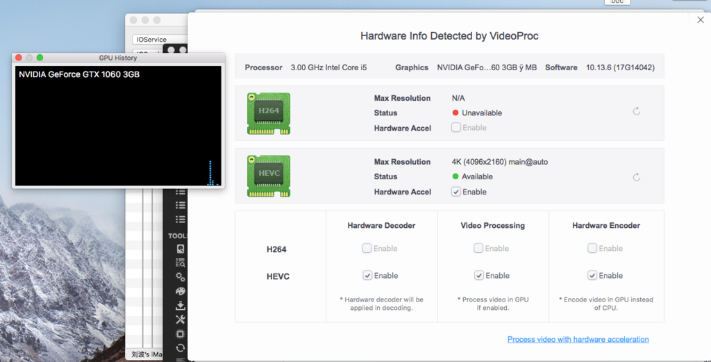

ryuu_nami Posted March 9, 2021 Share Posted March 9, 2021 Intel i5-8500 iGPU headless nVidia GTX1060 3GB Nectar 120GB SSD EFI folder attached. High Sierra 10.13.6 Clover bootloader Problem #1: Whenever I boot up the system, I have to switch off the display and power it back up to able to see the login screen or I will get a black screen. I can see the boot up process. But when i get into the login screen, it just gives me black screen. Problem #2: I think I installed a proper driver for my iGPU. But when I open GPU activity window within activity monitor, i get a Intel KBL (I think it's Kabylake) unknown. When I check H.265 hardware decoding abilities in VideoProc, it just gives me nVidia GTX1060. Shouldn't it be Coffee Lake ? I know iGPU acceleration is really important. Sometimes I need this machine to do some video editing work for me. Problem #3 I have my internal speaker and headphone jack working, but I can't get my DP or HDMI audio working. How can i do that? Problem #4: In System Info, my processor is displayed 3GHz unkown. How can i get my process properly displayed? Problem #5: When I load up clover bootloader, I always hear the chime sound of apple computer. How can I disable it? These problems have plagued me for eons. I am new to hackintosh and I've been searching for answers for a long time. I hope someone could help me with that. I will really appreciate your help! Thank you! EFI 2.zip Link to comment Share on other sites More sharing options...

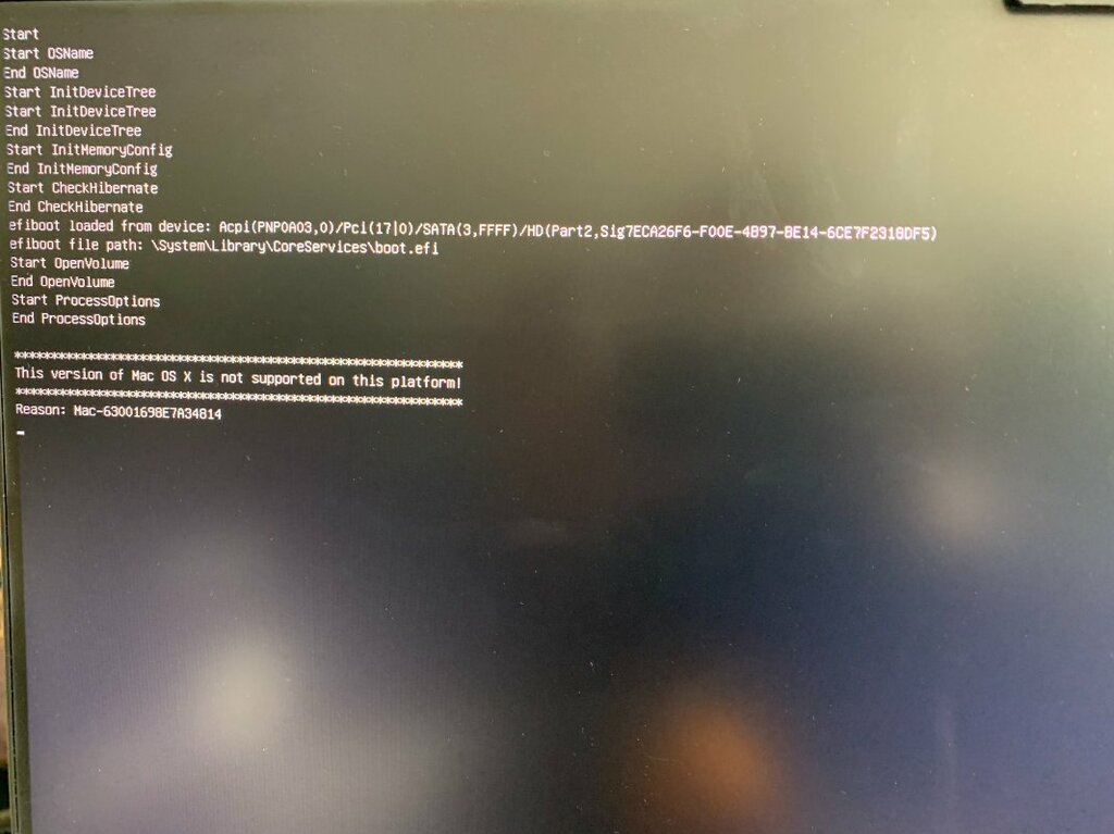

ryuu_nami Posted March 10, 2021 Author Share Posted March 10, 2021 @Hervé I've changed my smbios to imac19,2. But boot process shows that high sierra is not compatible with this platform.( screen shot included) I've remove cpupm and cpu01st table drop and generate p states/c states. I am not using any DSDT or SSDT. I don't how to patch. I am still a newbie. Yes I am using nVidia Web driver. I removed the audiodex.efi and no chime now. But I didn't find the wav file. Is the sound generated on the fly? I need to use high sierra, because I am using a gtx1060 graphics card. Anything higher than high sierra won't work. I am stuck here. I can't get back into my system now. What can i do to cope with that? Thank you! Link to comment Share on other sites More sharing options...
Moderators Jake Lo Posted March 10, 2021 Moderators Share Posted March 10, 2021 add to boot arg -no_compat_check but you'll need a bootable disk to get back into the system 1st. Link to comment Share on other sites More sharing options...

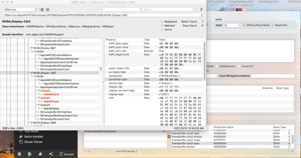

ryuu_nami Posted March 10, 2021 Author Share Posted March 10, 2021 @Jake Lo I get into the system and actually nothing changes. I remove all acip renames. I actually don't need them. I am using my nvdia gup to drive my diskplay and i see from ioreg that i use con2 and type info is correct I think. I am using a Benq display and it has two three inputs one hdmi one dp and one vga. I use hdmi for my mac mini and dp for this dell hackintosh. When i switch from hdmi input to dp, i get a flash of the desktop and then it turns into black screen. i have to reboot my display to see my desktop again. I think it is due to connection type. I patched con type in clover but i doesn't work. (screen shot attached) I use my igup in headless mode. So i changed AAPL,ig-platform-id from 07009B3E to 0300913E, but i got a "could not register with framebuffer driver" message during boot up. It seemed i have broken something. Also I lose h264 decode capibility. I am really frustrated. How can I get out of this mess? Link to comment Share on other sites More sharing options...

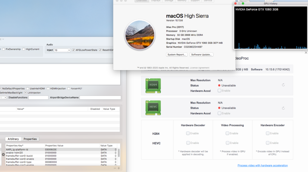

Moderators Jake Lo Posted March 10, 2021 Moderators Share Posted March 10, 2021 From what I had read, the best result would be to use 0300923E and iMacPro1,1 Link to comment Share on other sites More sharing options...
ryuu_nami Posted March 10, 2021 Author Share Posted March 10, 2021 @Jake Lo I give it a shot and the result is no good. I seemed to lost all my decode abilities. (screen shot included). Any other sugesstions? it seems that imac19,2 can cover my cpu, but it is not recognized by high sierra. But i just can't use mojave or higher. I need my gtx1060 to work. Link to comment Share on other sites More sharing options...
