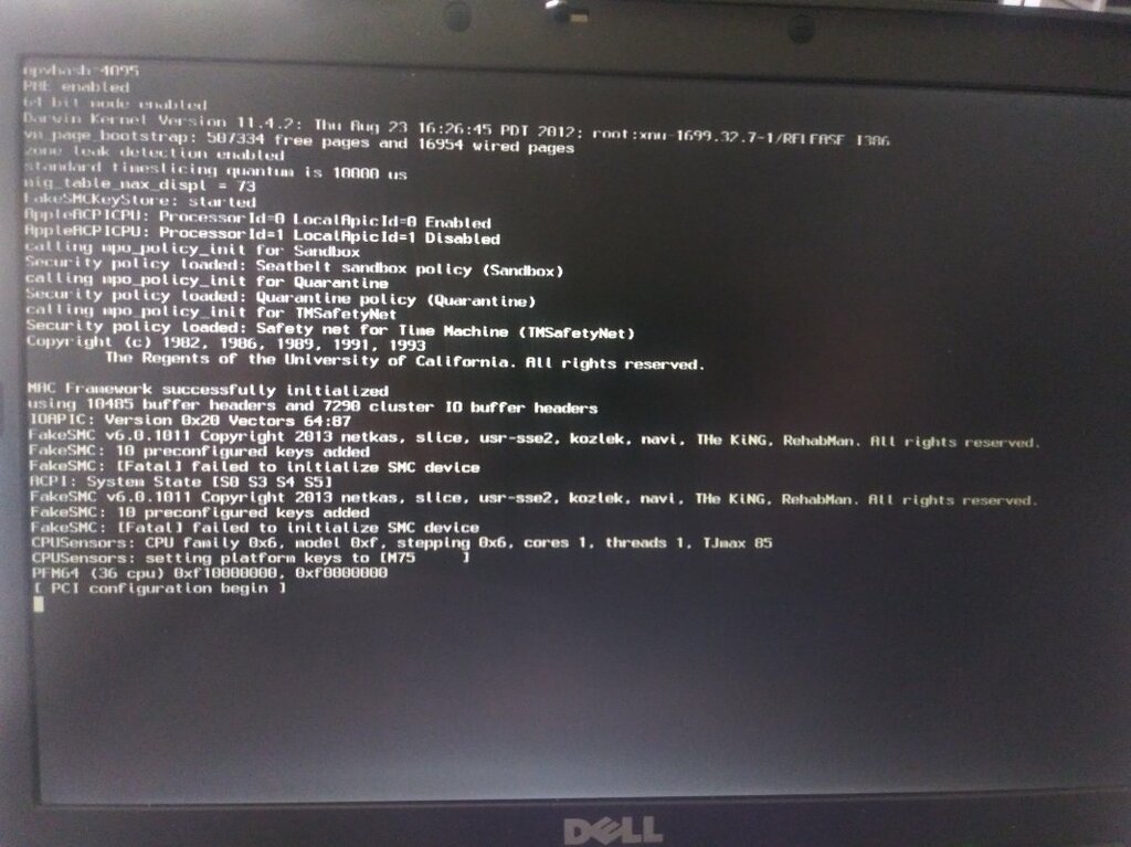

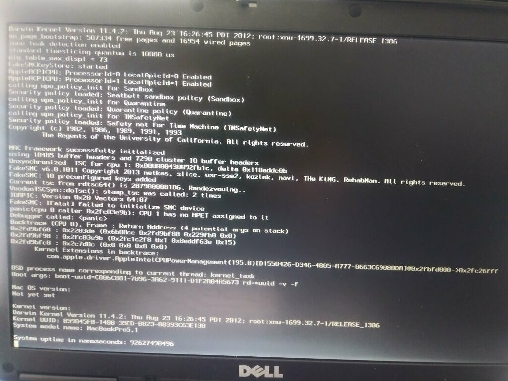

EVH Posted May 13, 2021 Share Posted May 13, 2021 Update to my previous thread about installing SL on my D620. Since I was unable to get the Snow Leopard installer to go beyond 4 lines on verbose mode and I was able to run the Lion installer with rather more success I decided to install Lion. Only thing was I had a Core Duo so I upgraded the CPU and got the Lion pack with My hack 3 .3.1. I am however getting a FakeSMC fatal error (see pics). Bios version is a10 I have so far: Added the following flags at boot: -v but when that didn't work then -v -f and when that didn't work then -v -f -x Toggled ===> Virtualization on and off ===> Speed step ===> hard drive performance or bypass options Disabled -Wifi (is there a hardware button to achieve that also?) -Bluetooth -Printer port -Serial ports But Fake SMC has to do with the CPU right? (I'm a forever newbie at this) Lastly, I did apply the extra folder in MyHack. I'm attaching some pics. Any ideas? Thanks in advance for your input Here's a more complete kernel panic pic at the very end where it hangs. Link to comment Share on other sites More sharing options...
Administrators Bronxteck Posted May 13, 2021 Administrators Share Posted May 13, 2021 do you have sata set to AHCI? you might need acpi HPET device patched or voodootscsync kext added. Link to comment Share on other sites More sharing options...
EVH Posted May 13, 2021 Author Share Posted May 13, 2021 Bios version is a10. I don't remember have seen an AHCI option under sata to my recollection but will check. You mean I should add that to the MyHack Extra folder? I did follow the instructions in the sense of having downloaded the correct pack which was the D620_NV110m_10.7.5_Pack for Lion installer. Shouldn't that pack be there? Should I resort to the old EDP installer method? Link to comment Share on other sites More sharing options...

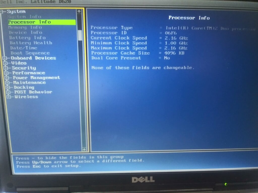

Administrators Hervé Posted May 13, 2021 Administrators Share Posted May 13, 2021 No AHCI option for the Latitude D620, the disk can only be run in IDE mode. As for EDP, it was abandoned many years ago and it's no longer relevant. The bootpacks I posted cater for everything and all is fully tuned. Your issue has nothing to do with FakeSMC, which is unrelated to CPU. FakeSMC does what its name implies: it fakes the SMC of an Apple Mac. What you're experiencing is a KP on CPU power management, which is unexpected because you seem to have applied our bootpack properly and I can see in your screenshot that VoodooTSCSync kext is loaded. SpeedStep should be enabled in BIOS (or system will run like a dead dog). You could always try and add NullCPUPowerMangement kext to the Extra/Extensions folder as a temporary workaround until you suss out the problem. You'll need to re-run MyHack->myFix afterwards of course. One thing I find very odd, though, is your BIOS screenshot which shows: Dual Core Present = no. You can't run Lion without a dual core 64bit Core2Duo CPU at minimum. What CPU model did you go for when you upgraded? Merom T7400? Make sure you set your BIOS settings as per the recommendations specified in our dedicated our thread on the matter. It's available at the top of this very D6x0 forum section. On top of SpeedStep, Multi Core Support must be enabled! Link to comment Share on other sites More sharing options...
EVH Posted May 13, 2021 Author Share Posted May 13, 2021 Thanks Herve for your detailed response. The processor I've got was this: SL9SE Intel Core 2 Duo T7400 2.16GHz 4MB 667MHz Processor CPU. I did toggle everything I could on the BIOS and I probably tried running the laptop without multicore support. Re: NullCPUPowerManagement, do we have a Kext library? I'm still sort of getting acquainted with the site. And thank you again bud. We'll definitely give all your suggestions a shot. Will look for the BIOS settings recommendations at once too (I don't know yet where they are but I sure should be able to find it) Link to comment Share on other sites More sharing options...
