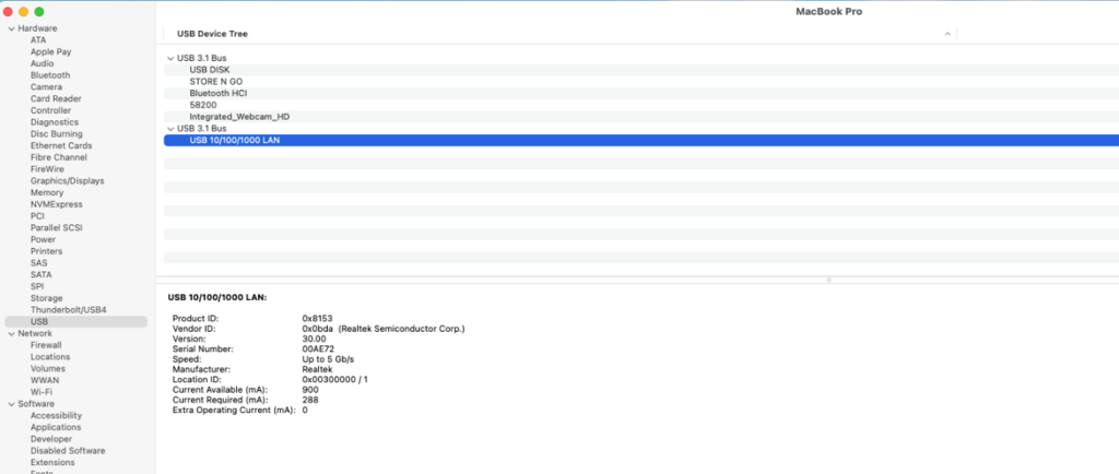

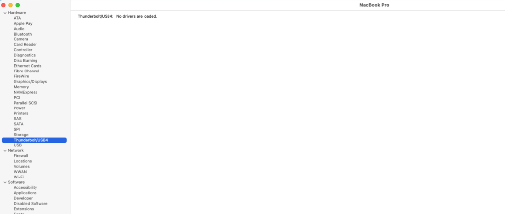

dodox Posted May 25, 2021 Author Share Posted May 25, 2021 The device does have 4 Ports (2 USB3 Ports on the right and 2 USB-C ports on the left). At the time of the IOReg 2.1 export there were devices connected (don't know if that matters / helps). On the right side two USB Keyboard / Mouse dongles - on the left side one USB-C LAN network adapter and a Thunderbolt dock (DELL TB16). The forum does have a file limit - please take the EFI from the first post as this has been compressed by 7z (I used a different computer for this as it is not available on my mac). Attached IOReg. Thanks! 7410.ioreg Link to comment Share on other sites More sharing options...

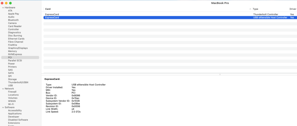

Moderators Jake Lo Posted May 26, 2021 Moderators Share Posted May 26, 2021 You still need VoodooPS2 for keyboard. The voodooI2C is for touchpad only. Get rid of VoodooI2CElan. Not for this system unless you're sure it does. When re-enabling VoodooPS2, make sure to leave out voodooInput since you already have it in VoodooI2C. Having both will cause KP. According to your new file, custom USBport kext is still disabled. Yes each time you make any changes, IOReg file will change as well. Do all the update above, but remove ssdt-typc. Boot with all the USB ports connected. Launch MacIASL which will launch the System_DSDT. Compress and attach the file. When you have the USB-C device connected, does it show as a PCI device on the menubar? Link to comment Share on other sites More sharing options...

Administrators Hervé Posted May 28, 2021 Administrators Share Posted May 28, 2021 ExpressCards? Would you mind elaborate on this please? Link to comment Share on other sites More sharing options...
dodox Posted May 30, 2021 Author Share Posted May 30, 2021 What do you mean? I dont have any hardware modification or something plugged in. They are listed as express cards - I dont know why. Odd, in comment #109397 me replies to your answer were deleted?? Link to comment Share on other sites More sharing options...
