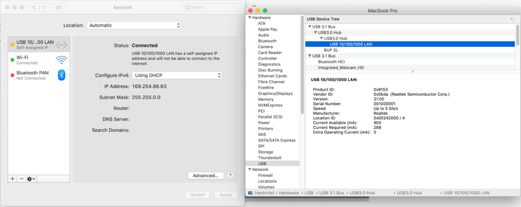

muttonhead411 Posted July 23, 2021 Author Share Posted July 23, 2021 Hey Jake, - Trackpad fixed, you were spot on on VoodooI2C Input.kext being the cause - Added SSDT-TYPEC.aml in, attached IOREG profile - Ethernet USBC Hub, interestingly I found a few things, not sure what to make of it. It seems to be detected correctly... I checked its hardware on windows as well: Thanks again for your help. I really appreciate it. Hackintel.zip Link to comment Share on other sites More sharing options...
Administrators Hervé Posted July 23, 2021 Administrators Share Posted July 23, 2021 Realtek RTL8153 GigEthernet of WD15 Dock certainly used to work OOB in Mojave and Catalina: https://osxlatitude.com/forums/topic/11410-dell-latitude-7490-with-i7-8650u-intel-uhd-620-and-1920x1080-lcd-mojavecatalina/?do=findComment&comment=90288 I would therefore expect it to work for you too. Link to comment Share on other sites More sharing options...
muttonhead411 Posted July 24, 2021 Author Share Posted July 24, 2021 Thanks for the help and verification, after some experimenting, and looking through the documentations for ITLWM kext, I realised that the kext was spoofing the wifi card as a LAN NIC, and hence kept masking the IP for lan connections. After turning wifi off, and unplugging and replugging the usb C doc, lan connectivity was restored, with full speeds. This workaround is acceptable for now. @Jake Lo I noted in your original OC0.7.1 config file, you excluded SSDT-PNLF-CFL, and included SSDT-BCKM instead. Are they both required? or should I just stick with BCKM only? Thanks! Link to comment Share on other sites More sharing options...
